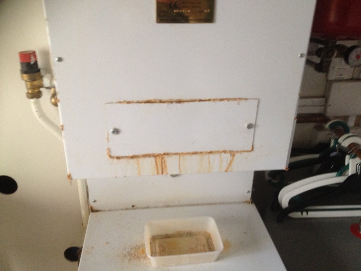

Basically i've got a model 1 in a customers house which has started to corrode through the top access panel, i'll try and post a photo. Is it likely to be the condense tray?
If so have you got one i could get dimensions of to get one fabricated?

You need to take the top white casing off, this is a white model so is not older than around 16 yrs. Unlikely to be condense tray, more likely the sealant hasn't been applied properly around the inner economiser access door on annual servicing, or the wrong sealant has been used.
If the tray has gone it is a pig to change, but the white casing would have rotted at the base of the economiser, not usually around the panel pictured. Also, the lid would be rusty.

I've had it all off, couldn't see anything obvious, it's a 2002 model.
It'll almost certainly be a pin hole in the mastic around the economiser cleaning panel; try squirting LDF over it.
