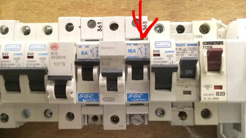

just wondering if the sizing of a consumer unit's mounting rails are standard i.e. If I bought an MK consumer unit, would a Crabtree RCBO fit in it, or must I use all MK breakers too?
I ask because I'm considering buying more ways than I need and blanking them off, rather than filling it up with RCBOs I don't have a use for right now..
No, far from it. Most MCBs/RCBO's are different heights, have different terminal hole sizes and locations, the depth of them is different and most of all, manufacturers do not type test other brands in their boards, so whilst it may fit, if you have a problem, it's not MK's problem.
A photo I pinched from RF
full
and some of mine

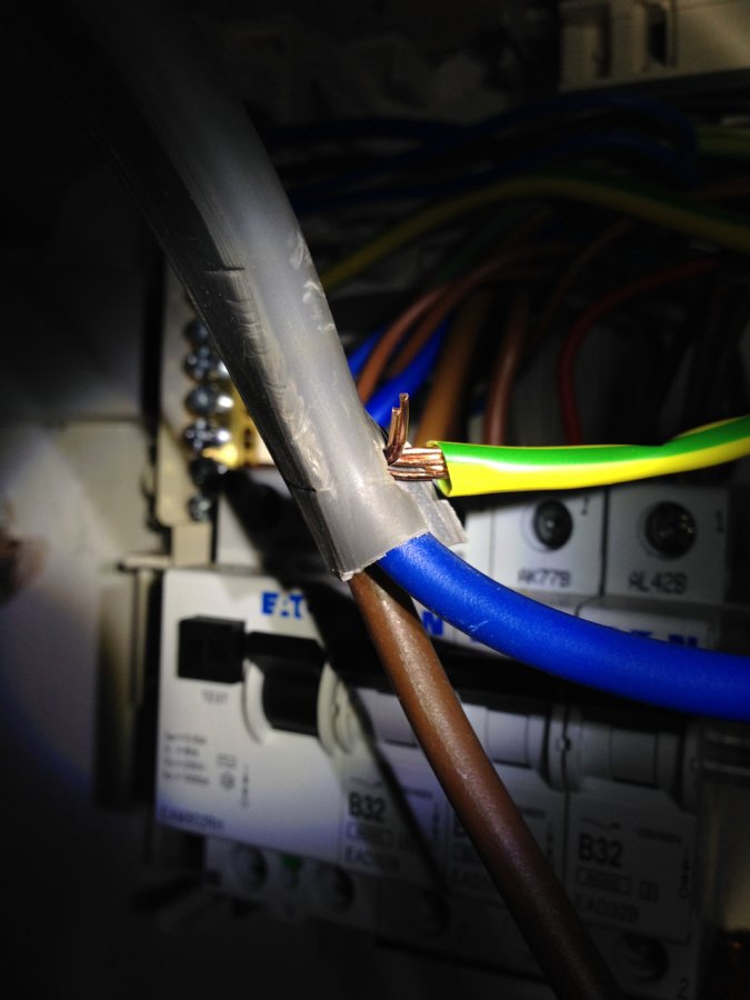

Notice the different width in the old MCB in the middle, means the new Eaton MCBs/RCBO's do not fit the old MEM busbar without filing it down, and even then because of the height difference, you would get very little copper contact
That last pic: they're not sparks, they're butchers.:eek:
