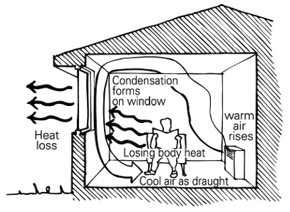

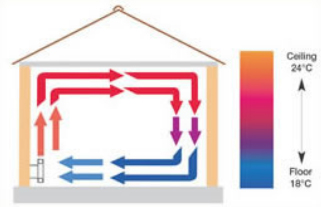

This circulation.jpg looks grand, but in three dimensional homes, some thing some where will interrupt that flow. This was the problem with my first house and hot air heating, the fans ensured even with furniture the air was circulated, although at first glance that may seem good, what it did was remove the cold air from next to the windows so more heat passed through the single glazed windows.

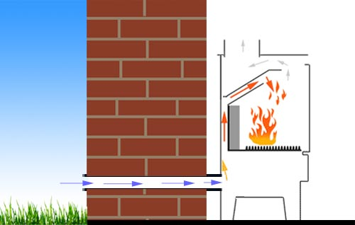

We get circulation2.jpg this problem, and the debate as to if a radiator should be on an outside wall or internal wall has gone on for years, well before central heating became the norm.

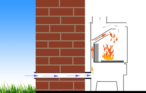

The solid fuel fire needed combustion air, placing it on the outside wall means combustion air can be drawn easy from outside, so with vents near the fire drafts were reduced, but in the centre of the house, less heat lost through walls, but needed high backed chairs upload_2022-1-23_12-7-24.png to stop the draft unless ducting was fitted for the combustion air.
The problem is homes have changed, with double glazing and cavity wall insulation, and loft insulation and outside doors with good seals and drafts have been excluded from our homes, which also means natural air circulation.
Heat recovery units may help, but we must not forget many homes still have the option of using solid fuel, there are upload_2022-1-23_12-20-8.png room sealed stoves with external air supply, but not very common. So we have to be careful with anything blowing air outside, be it a cooker hood, tumble drier, or bathroom extractor, we don't want exhaust gases being drawn into the home.
One system I came across, drew it's combustion air from below the floor - sometimes a cellar, sometimes a simply the space below a wooden floor above the dirt.

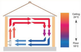

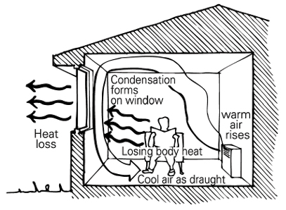

This View attachment 258441 looks grand, but in three dimensional homes, some thing some where will interrupt that flow. This was the problem with my first house and hot air heating, the fans ensured even with furniture the air was circulated, although at first glance that may seem good, what it did was remove the cold air from next to the windows so more heat passed through the single glazed windows.
We get View attachment 258442 this problem, and the debate as to if a radiator should be on an outside wall or internal wall has gone on for years, well before central heating became the norm.
The solid fuel fire needed combustion air, placing it on the outside wall means combustion air can be drawn easy from outside, so with vents near the fire drafts were reduced, but in the centre of the house, less heat lost through walls, but needed high backed chairs View attachment 258443 to stop the draft unless ducting was fitted for the combustion air.
Heat recovery units may help, but we must not forget many homes still have the option of using solid fuel, there are View attachment 258444 room sealed stoves with external air supply, but not very common. So we have to be careful with anything blowing air outside, be it a cooker hood, tumble drier, or bathroom extractor, we don't want exhaust gases being drawn into the home.
