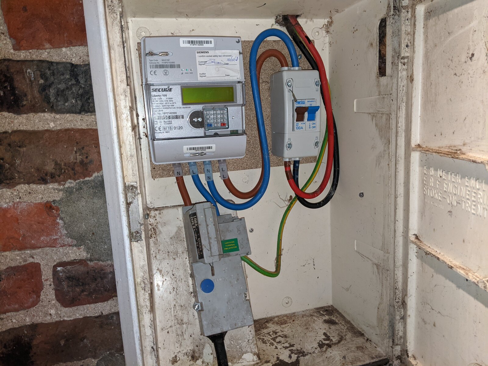

  1. In the pic below, there's a blue cable with a L on it and a brown with a N. I thought Blue was always meant to be Neutral and L for Line. Are they labelled correctly?
  2. Who's responsible for upgrading the tails out of the isolator (the red and black ones)? If I want to upgrade them to be the more modern blue and brown ones who would be responsible for that? (me or the meter company)
  3. Who's responsible for upgrading the earth tail.. if I want to upgrade to 16mm who would be responsible for that? (it's currently 25mm)
The N&L single markers are in the wrong place. The colours are correct, as are the positions where they connect to the cutout and meter.
The red/black wires are yours, and if you want them replaced then you must pay an electrician to replace them. Same for the earth wire.
No, but they are in the correct place - i.e. wired correctly.
You or your electrician. Why bother? The colours don't matter.

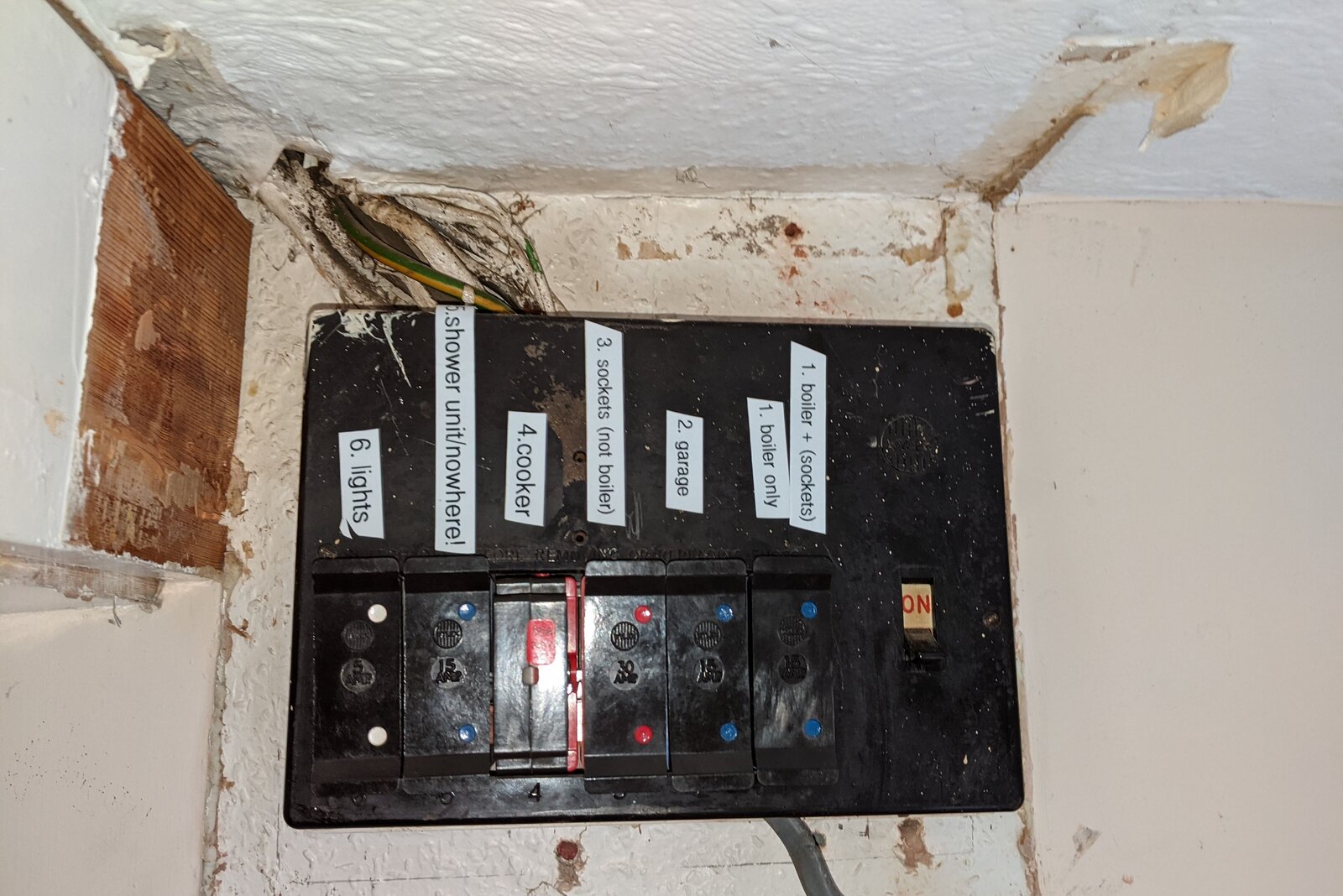

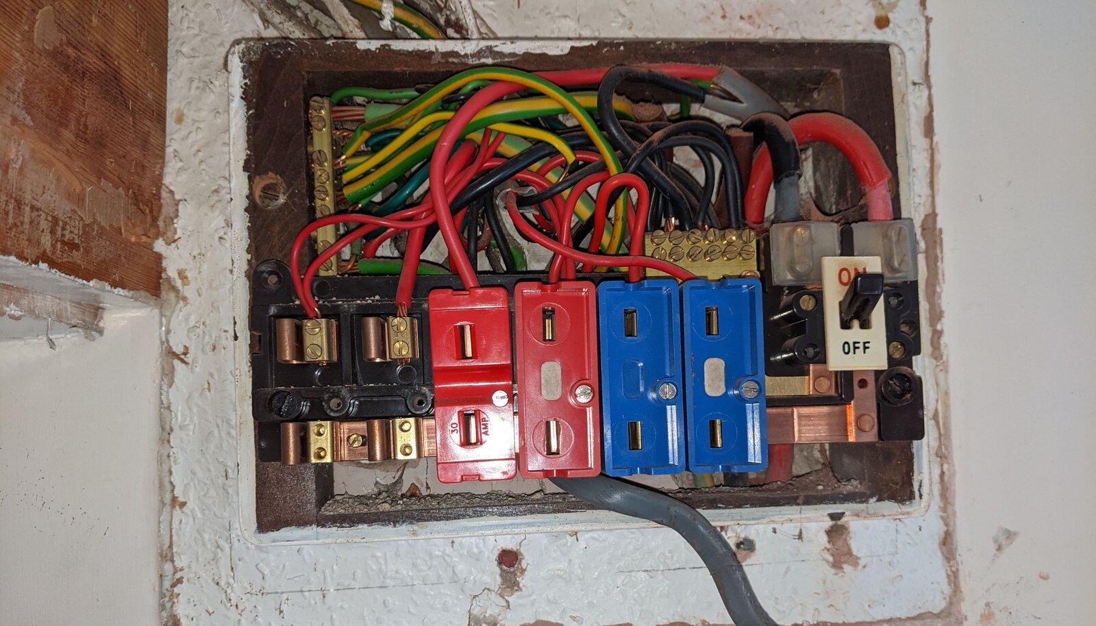

It's on a old wylex CU at the moment. You can see how the earth's wired in from the pics below.. it seems to be going straight into a terminal?. By the way I know maybe I'm not supposed to take the cover off but I wanted to get an idea as to what I need to get done. I put the labels on - and pulled each fuse to figure things out.. fuse number 5 seems to not go anywhere.. I was a bit confused by 1 as well.. maybe it doesn't go to sockets
I put a LED lamp into one of the sockets and it was flickering.. when i put 1 back in it was nice and bright!
by the way fuse 6 has burn marks
I would have thought it impossible to connect a 25mm2 earth cable to a tiny earth terminal in an ancient fuse box like that without some form of butchery.
you may well be right.. may be they snipped some of the strands. It's definitely 25mm though
