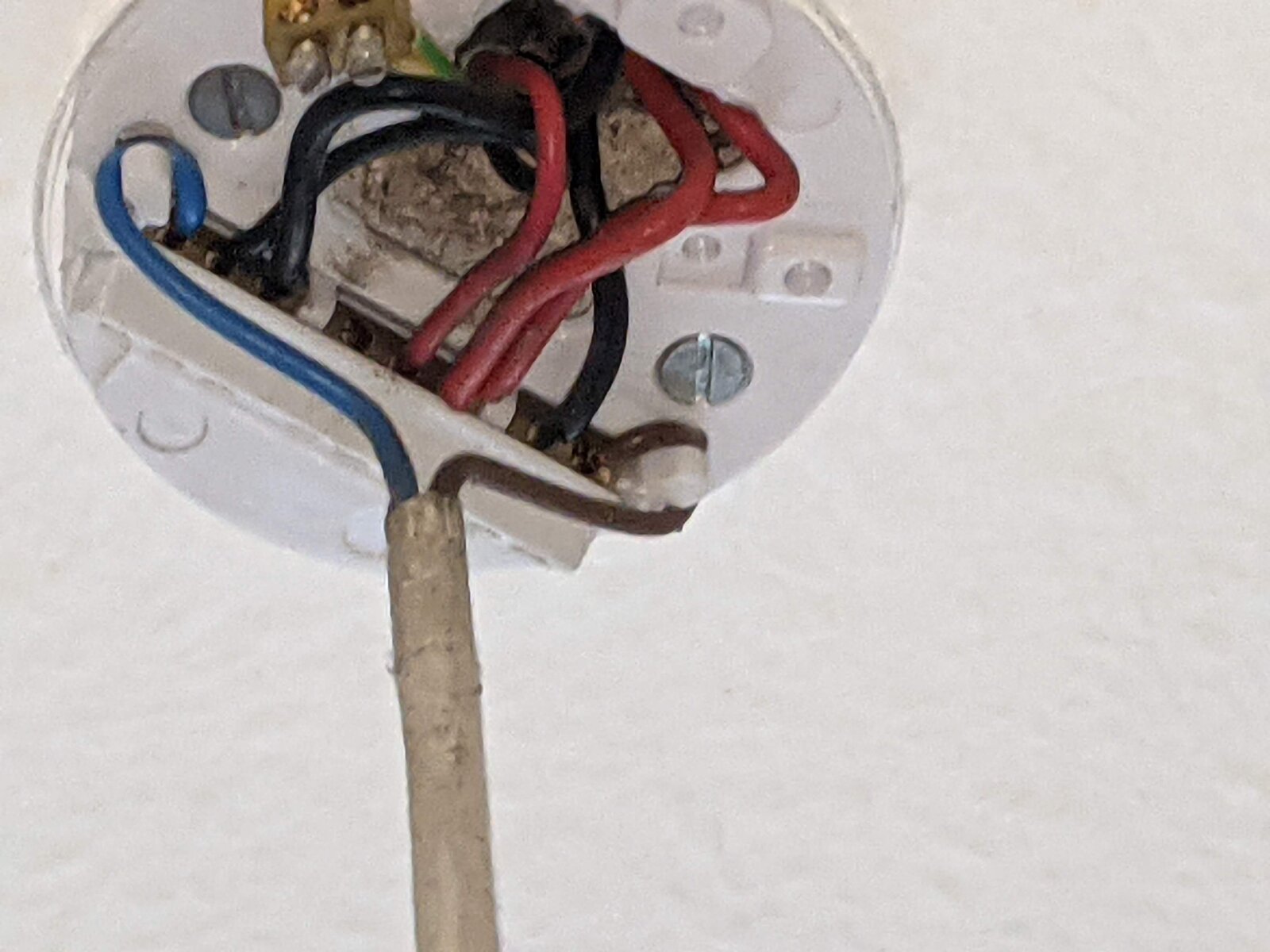

Are these meter tails labelled correctly? *PIC*

You or your electrician. Why bother? The colours don't matter
technically there's more to it than just the colours. Those old 25mm red and black tails have less strands in them - meaning they are hard to bend
The modern ones have more strands and are thus more flexible
technically there's more to it than just the colours. Those old 25mm red and black tails have less fewer strands in them - meaning they are hard to bend
Different type of cable - not related to the size.
Of course, having now seen the consumer unit, you might only have a 60A main fuse (the 100A label is just the maximum) which means 10mm² 'tails' would be sufficient in which case the earthing conductor need only be 5mm² (using 6mm²).
Just because someone has fitted oversized tails does not mean the earthing conductor has to be larger than the required size.
