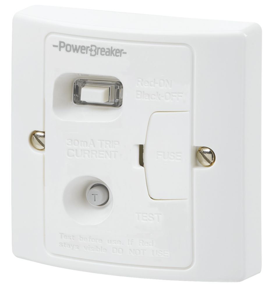

Hi thanks for your help, it is as follows:
The house's main consumer unit is RCD protected for mains power
Then inside the lounge on the wall there is one of these connected to the mains:
ae235
13A 30MA DOUBLE POLE PASSIVE RCD CONNECTION UNIT
Well you don't need that second RCD then. Two RCDs in line on the same circuit is pointless. It just means you have two to reset after a fault.
It was like that when we moved in, it's right on the other side of the house from the CU and is the socket the previous occupier used for the mower & garden tools
