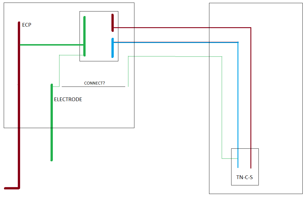

Yes, but as I keep saying, you have turned this into a discussion about outhouses, whereas I was talking about the general concept of connecting an earth electrode to a TN-C-S earth, which so many people (in UK) seem to think that is potentially hazardous and/or 'forbidden'.
As I've said, if there is a problem such as you describe (with an outhouse), it is going to be because of other extraneous-c-pc, not because of the earth electrode. Whether there are such 'other' extraneous-c-ps or not, connecting an earth electrode (with any credible cable ≥1mm) to the TN-C-S earth will not create any new hazard.

It is an example where the electrode must not be connected to the TN-C-S earth.
There is no 'general concept'; it depends on the installation.

So - there is no reason not to connect an electrode to a TN-C-S earth unless it is connected to other parts which may not be so connected (inadequate bonding back to source).
If the electrode is alone and so able to be connected what is its purpose? (Why is it there?).
It will if that path is via a distribution circuit having a 1.5mm² CPC to which is also connected a water pipe whose path to earth gives rise to a Zs of 0.2Ω.

That the electrode and extraneous-c-ps are connected.
Again, I find it hard to believe that in any real world situation, it would be possible for the path back to the 'source' (MET) not to be adequate for the earth electrode. The path may be inadequate for other extraneous-c-ps, but that's a totally different matter (which exists whether or not there is an earth electrode)
They cannot be separated.

That the 0.001Ω impedance e-c-p may be connected to the source earth by a very small conductor which in a fault situation may carry the full installation neutral current.

The current which could flow through the conductor to the earth electrode will still be limited (to a low value) by the impedance of that electrode.

Mr Ohm might be turning in his grave! If (very optimistically, domestically) one assumes that the earth electrode has an impedance of 20Ω, the greatest current that could flow along the conductor to it would be 11.5A (and that only if the conductor were connected directly to a 230V source) - and, as I've said, a 1mm² conductor would be OK for that. More commonly, the electrode would probably be at least 50Ω, in which case the maximum current which could flow would be 4.6A (so 0.5mm² cable would probably be adequate :-) ). Again, what is this perceived 'hazard'?

...but that current would also find its way to the very low impedance extraneous-c-p after flowing through the 1.5mm² CPC to the outbuilding.
If not, what is the need for 10mm² bonding conductor?

The small CPC to a TT outbuilding would become the bonding conductor if you connect the TT earth (the electrode) to the TN-C-S supply earth.
A thought - what are you going to use to connect the electrode to the supply earth?

I can see that we're getting abit into semantics here. If, sticking with your 'remote location' scenario, one has a conductor which is connected to a TN-C-S earth at one end and to a 'TT' earth electrode at the other end, it's really fairly arbitrary as to what one calls that conductor.
That (and only that) is what I have been talking about - and, as I said, I see no reason why, electrically speaking, it would ever need to be bigger than about 1mm² - whether all the way back to the MET in that CSA (if there are no other extraneous-c-ps) or just as far as a larger-CSA conductor bonding other extraneous-c-ps.
I am ignoring the question of why one would want two different earths connected together, since that's a different matter! The only point I'm making is that, AFAICS, connecting an earth electrode to a TN-C-S earth (anywhere) is never going to do any harm - although I'm not sure what 'good' (other than "adding an M") it would do. As for your outbuilding scenario, the real choice is to EITHER just use to TN-C-S earth (with adequate bonding for any "very low imoedance extraneous-c-ps") OR to insulate the outbuilding from the TN-C-S earth and just TT the outbuilding (including the bonding of any other extraneous-c-ps) - I see virtually no merit (albeit 'no harm') in 'both'.
