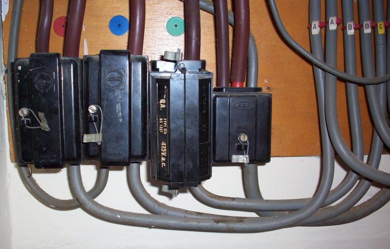

Furthermore, in my installation, I wouldn't have a clue as to which is L1, which is L2 and which is L3. In their infinite wisdom, the DNO have identified my phases as red, blue and green and "A", "B" & "C" (and the incoming neutral is identified by red insulation :) ) !! :
Kind Regards, John
