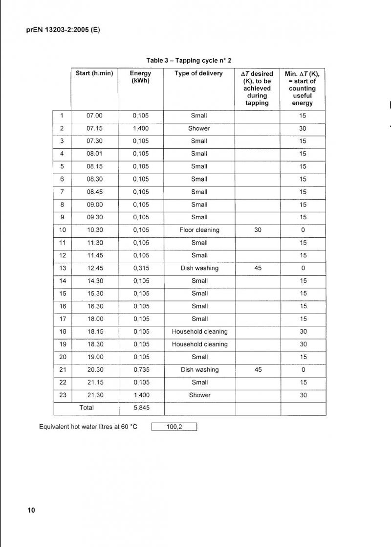

I asked them how they get their "default values" and this was the reply:
passed me your enquiry about the significance of the term ‘default value’ in the context of hot water energy efficiency in the PCDB.
The PCDB exists primarily to provide information for SAP assessors rather than as a product comparison system.
The assessment procedure includes domestic hot water. Therefore, all entries for combination boilers need to include a value for hot water energy efficiency.
However, the value included in an entry depends on the information submitted with the application for product listing. The provision of hot water energy efficiency data is not mandatory for submissions to PCDB.
The procedures used to determine the value entered in the database are those provided in Appendix D of the SAP 2012 document (http://www.bre.co.uk/filelibrary/SAP/2012/SAP-2012_9-92.pdf).
If no hot water data are submitted with an application the procedure in section D3.4 is applied to determine the value to be used in an entry. We refer to values derived using this procedure as ‘default values’. The procedure results in conservative values for hot water energy efficiency.
I hope that this answers your question.
