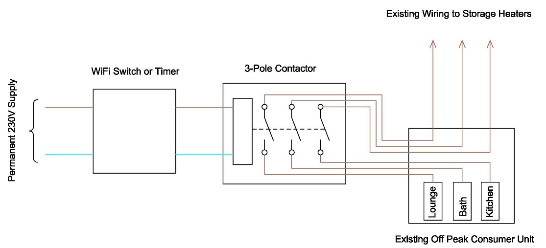

As @JohnW2 has already pointed out. If the supply from the wall switch that you are proposing to wire the timer into, is controlled via a dedicated 'off peak' supply, then the power supply to it will be lost during the day, so the timer won't have any power and will stop. Some timers do have battery back up, but they are designed to for use during a brief power cut, not daily use.

A better alternative is to have a timer running from the permanent electricity supply. The timer then switches a relay that is wired into the off peak supply to the heater. With this scenario, you could use a WiFi switch instead of a timer.

What I suggested would just operate the single heater as per your sketch. Although it would be possible to mount a three pole contactor next to the consumer unit that would switch all three heaters. I wouldn't recommend it for a DIY project though, you would need to be electrically competent to do it. Although it wouldn't be a big job though for someone that was.
EDIT
Here's a sketch showing what I mean:

Thanks so much stem.
Defo worth me thinking about the 3 pole connector. Thanks for the diagram.

Actually, on reflection, I think that most of the electronic 7-day wire-in 'immersion timers' would work OK. I have used several of these (click here) - or, at least, older versions thereof. As you will see, the internal rechargable battery is said to give 720 hours 'cover' during power loss. The battery may not be man enough to work the relay, but so long as one made sure that the 'switch on' time was after the start of the E7 period (and the switch-off time before the end of that period), the mains supply would be present by then - so all the battery (which would be 'on charge' for 7 out of every 14 hours) would be having to do would be to keep the clock going continuously.
I would personally be inclined to give that a go - and, as the OP has suggested, it could be simply wire intoi the feed to (one) heater (but the other heaters would all have to be switched off whilst the OP was away). That would certainly be simply for him than using a contactor.

The option of using a contactor is a good one.
It is physically possible to fit a DIN rail single pole contactor into a consumer unit to control the supply to all MCBs.
Whether it is compliant with latest regulations / type approval of the CU I do not know.
