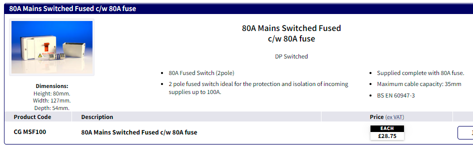

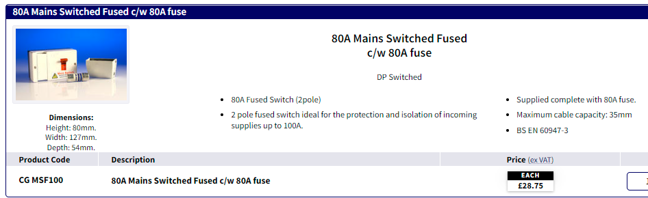

The question I have, therefore, is whether there an alternative, less bulky, arrangement to the switchfuse that would free up space for the C/O switch.
If 80A is enough, then how about one of these, which is about the same size as a double socket - although I'm not sure how you would/could terminate SWA into it (I have several of those in my installation) ...
Kind Regards, John
Kind Regards, John

Thanks for link to the small fused switch. That would do the job but I suppose would need an intermediate metal box to terminate the SWA.
