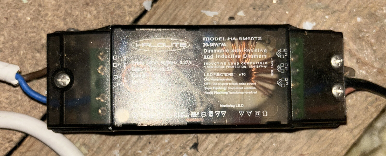

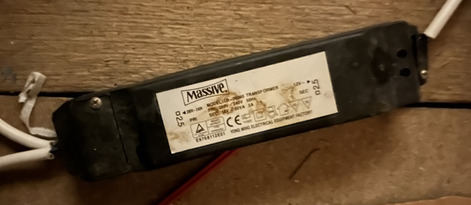

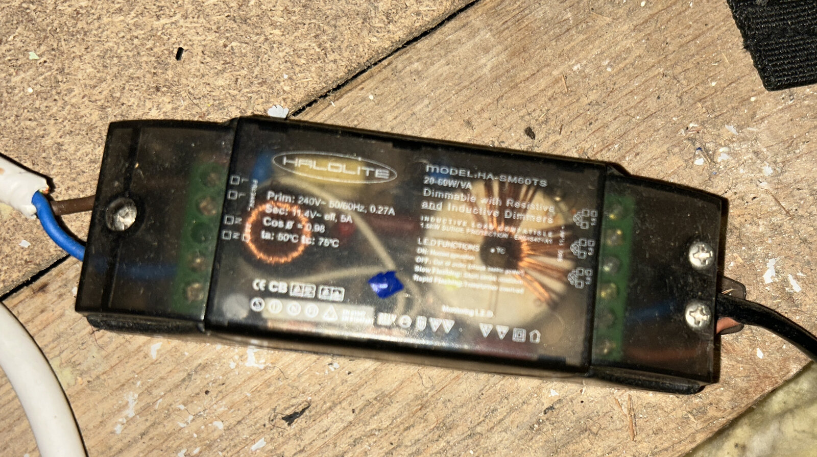

Hiya!
My bathroom currently has 6 x 20w halogen (GU5.3 mr16) 12v downlights which are powered via 2 drivers, 3 lights per driver. 3 of the lights have been out for a while so after investigation it looks like one of the drivers has failed. These were installed by the previous owner. I want to change all the bulbs to the equivalent LED (about 2W..... or maybe lower as the room isn't huge!) So do I replace both drivers (they are old..... well defo one is!) and keep them on 2 circuits if one fails again, or do I just run all 6 lights off 1 driver? Either way, any recommendations on good LED drivers and what kind of wattage would they need to be? LED's pull larger power when switched on I was told? Would need to take that into account. I have attached pics of the drivers. Note the one states 20-60w. The other one states 60VA which I think would be 60W also? That makes sense but in my opinion was cutting it close as it would be running 3 x 20w bulbs! Not sure which one has given up as I hadn't got my multimeter handy. Guessing the huge black brick tho! lol!
Any help would be brilliant! Thank you in advance!
