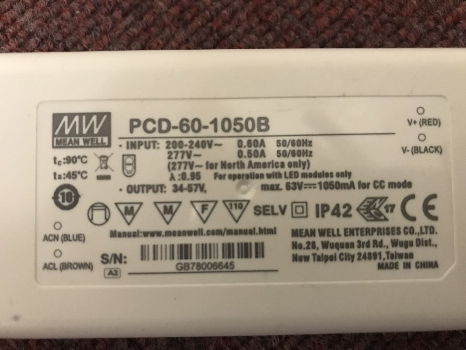

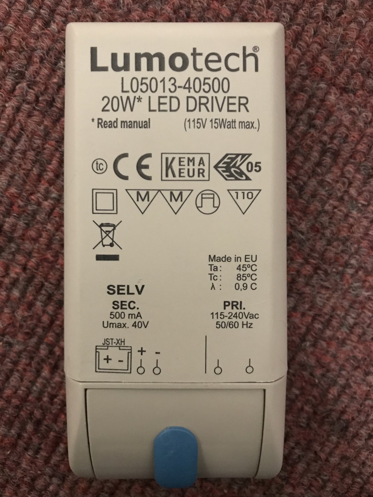

If you look at table 2 (Electrical and Thermal Characteristics), you'll see that the nominal current rating is 700mA - so neither of the drivers you've tried is "correct". 1050mA is the maximum continuous current (table 3, Absolute Maximum Ratings) - you should NOT be designing to drive at that level as it gives you zero headroom in your design.

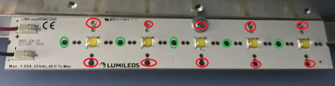

So returning again to table 2, at 700mA and Tc=85˚C (which is max operating point from table 3) the max forward voltage of the 5 LED unit is 55V. So that's a max of 0.7 * 55 = 38.5W. Table 2 gives thermal resistance from junction to heatsink surface as 1.2 K/W (degree/watt) - so at 38.5W that gives 46.2˚C between heatsink face and junction. With max juntion temp of 135˚C, that means you must keep the rear face of the board below 88.8˚C.
Having arrived at this point, you can now set your max ambient temperature, and choose a heatsink that will do that - with some headroom. And don't forget when speccing the heatsink that you also need to include the resistance between the board and the heatsink - a good thermal pad/compound works wonders, and check whether the board is electrically isolated (some aren't, in which case you may need electrical isolation which typically adds to the thermal resistance.
The heatsink Bernard shows wouldn't work as it's only about half the length needed - but it's the sort of style you'll need. The specs for that are 0.69K/W - but watch out for the effect of orientation on performance (check the spec sheet). But if we ignore thermal resistance between board and heatsink, we can add the 0.69 to 1.2 to get a combined 1.89K/W, and at 38.5W that gives a max ambient of 135 - (1.89 * 38.5) = 62˚C. Sounds high, but if inside a closed box, you need to consider that the inside of the box can get quite warm.

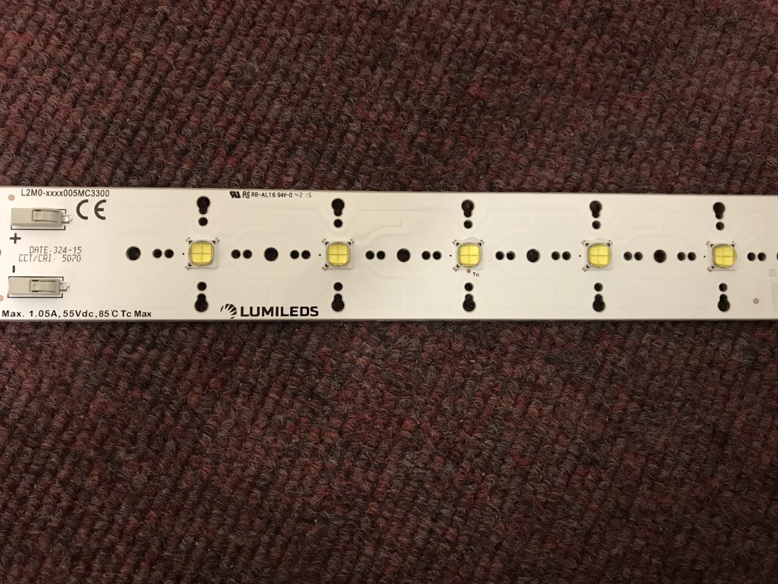

I was a bit confused when I first read the datasheet, since the introduction said "...These versatile building blocks come with 3, 4 or 5 LUXEON M LEDs on a MCPCB substrate ... ". However, since each of the 'LEDs' appears to have a typical forward voltage of ~11V at 700mA, I presume each of these 'LEDs' must consist of several (probably 4) actual LEDs ('LED elements') in series - is that the case?
Kind Regards, John.
Yes, these are arrays of LEDs packaged up with some basic optics. If you check the datasheet I linked to earlier, you'll see that they come in different combinations of series/parallel with different current/voltage combinations.
Thanks. Right - I hadn't looked at that datasheet, which is different from (but closely related to) the datasheet linked to from the RS link that the OP provided.
So, it seems clear (from 'your' datasheet) that the LED elements each have a forward voltage of 2.8V and that, as I suggested, the 3-, 4- and 5-module strips mentioned in the other data sheet (with forward voltages of 33V, 44V and 55V respectively) were putting in series 4 of those LED arrays, each of which contained 4 LED elements in series.
