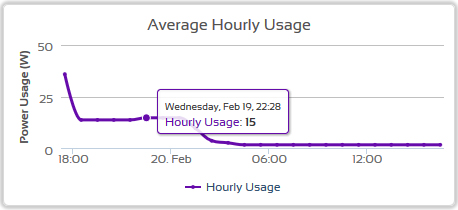

First hour as expected around ¼ hour at max of 3.8 amp dropping to 3 amp for around 2 hours then a long time at 0.8 amp, and finally dropping to 0.1 amp, area under the graph is the energy put into the battery, rough calculation shows that is about half the total declared capacity of the battery.
Problem for me is I have never been able to measure the energy used by a battery in the past, it would be charged using constant voltage rather than constant current, and the current would gradually taper off, because the charger has 4 steps, it is reasonably easy to see each step so 2 hours at 3 amp is clearly 6 Ah and 6 hours at 0.8 amp is around 10 Ah so only around 16 Ah of power was put into the battery before the final stage at 0.1 amp I will normally leave for days at 0.1 amp if not weeks, and it is likely still turning a little sulphur back into acid, but very little, it was in real terms fully charged after putting about 10 Ah back into the battery.
But I have never bothered before to note at what point a battery fails to start a car, and for a car in regular use, it likely takes less than 10% of battery capacity to start the car, likely more like 2% or cars which stop engine when sitting at traffic lights would not really do very well, had I not been monitoring the charge I would have assumed it would charge at max of 3.8 amp for a good length of time, but that seems rare, in the main batteries removed from caravan for recharging even at 110 Ah only charge flat out for 2 hours, then are at 3 amp for a good length of time, and at 0.8 amp for a few days, and it seems the smart charger does squeeze more back into the batteries than the float charger built into caravan.
