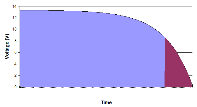

This is what I am trying to determine. What does 10% charge mean?
Is it, in the case of Eric's battery, only 3Ah remaining? If so, what is the voltage? Still 12V+?

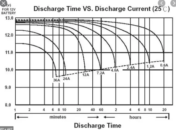

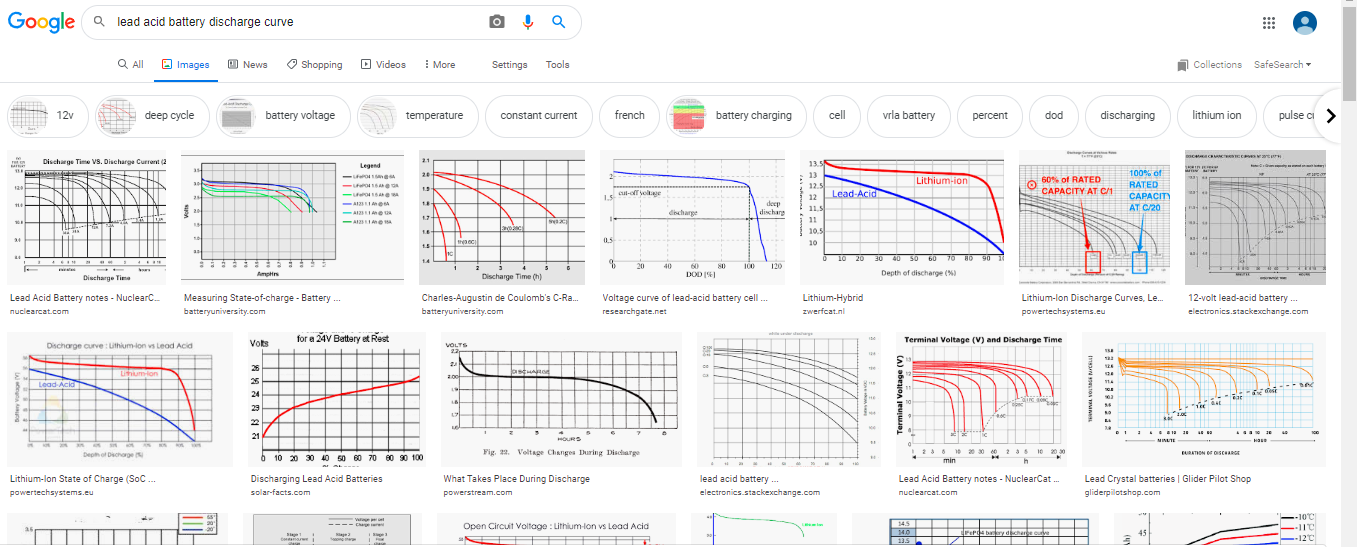

It sounds as if you might find it helpful to ask Mr Google about "lead acid battery discharge curves", since he has thousands to offer ...
What does 10% charge mean? ... Is it, in the case of Eric's battery, only 3Ah remaining? If so, what is the voltage? ... What values result in that? .... What are the values after that?
some of those curves may help you to understand the answers to some of those questions. It gets complicated because, as has been discussed the actual 'available capacity' of a battery with depend considerably on how rapidly it is discharged (i.e. as has been said, you'll get nothing like 70 Ah out of a fully charged "70 Ah" battery if you draw 100A from it. However, for the purpose of illustration, I'll talk about just one discharge current.

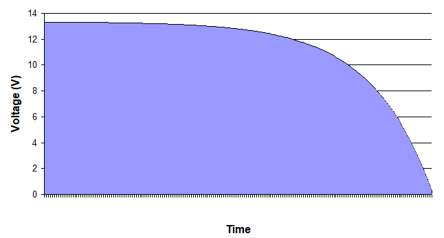

It just comes down to 'areas under curves'. For a particular discharge current, the 'total available capacity' is the entire are under the curve from when it's fully discharged to when it's voltage starts rapidly plunging towards zero .... i.e. the blue area in the following crude sketch (which is notr intended as anything more that a very rough illustration - so don't take too much notice of the numbers or actual shape):
when one gets to the point on the curve that there's only 10% of the (previously all blue) area (available discharge) left (the purple bit here), then that's "10% charged). In practice, one will obviously not go down to anything like zero volts, but the best I can do with some hasty graphics in the middle of the night :)
That sketch is all wrong, since it suggests that the voltage would not be much over 8V at that '10% point'. In reality I would expect it to be well over 11V. ... but it is about 02:30 :)

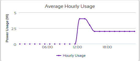

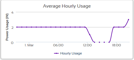

Having recharged the other batteries I put the charger back on the Jazz battery, set to under 20 Ah option as want it to fully switch off once fully charged, it went to 0.8 amp then started to alternate between 0.8 and 0.1 amp and then held on 0.1 amp as shown
I would hope in fullness of time it will start alternating between 0.1 amp and off, but held at 0.8 amp for over an hour, which seems to point to not being fully charged when I charged it last Wednesday around a week ago, so it seems I was right to question speed of recharge. The 20 Ah jump charging battery I charged did in fullness of time stop charging completely, but the 90 Ah ex Jag battery VRLA never actually switched off completely but sat there at 0.1 amp for days, however that battery is suspect, so not surprised. Want the car on Wednesday, if weather OK will walk tomorrow so will see what it does.

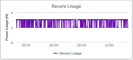

Update, today was working in flat and not really good having lead out of cat flap while opening and shutting door all the time, a bit of a problem with energy monitor is it shows only whole numbers, so 2 watt or 3 watt will not show 2.5 watt, current limited to 0.1 amp, so as the volts raise the watts also raise, clearly some loses in the unit, so at around 13.5 volt the monitor starts to flick between 2 and 3 watt.
So after turning off and back on again I get this graph.
Not quite true, on turning back on a couple of minutes at 0.8 amp, but that is not shown, but you can see the wattage raise as the voltage did, this
was what it shows, the monitoring unit is jumping between 2 and 3 watt. Since voltage still raising clearly the battery is still excepting more and more charge. It raises the question how long should you charge a lead acid battery before one considered it fully charged, now at 10 days, and most of that time charging at just 0.1 amp.
... the monitoring unit is jumping between 2 and 3 watt. Since voltage still raising clearly the battery is still excepting more and more charge. It raises the question how long should you charge a lead acid battery before one considered it fully charged, now at 10 days, and most of that time charging at just 0.1 amp.
As I've said before, the fact that current is flowing into a battery does not necessarily mean that it is 'accepting charge' (or necessarily 'getting any more charged').
