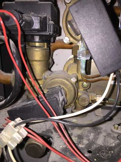

Still curious why the diverter valve cartridge seems to be different - I am guessing Baxi made some variations of this boiler? (I noticed that my diapghram is different too - most 105e's seem to have the bigger one whereas mine has the smaller one).
My diverter valve looks like this:
But most I have seen (in YouTube vids) look more like this:

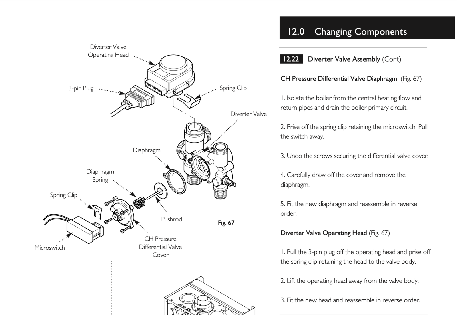

Thanks Ian - is there much difference between the two? I'm guessing the 'instant' means it has a pre-heat function whereas the non-instant don't?
Ah right, thanks! So will this expansion vessel fit my boiler?
It looks like lit might from the manual and this video:
Although I notice in the manual it says: "To replace the expansion vessel and pre-heat store it is necessary to remove the boiler from the wall" but in the video they say it does not : /

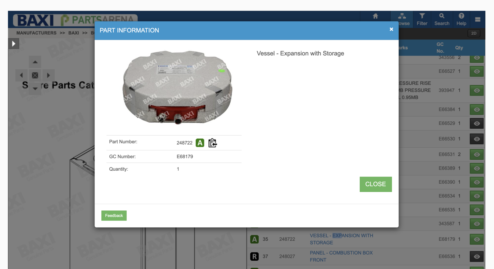

According to this page https://www.baxi.co.uk/trade/products-parts-and-accessories/parts/parts-arena it is the same part number (248722) but it has the cover on it whereas the one on eBay does not - does it look ok to you all?

yes if it has two pipe connections it is the correct one the 105E only has one connection
