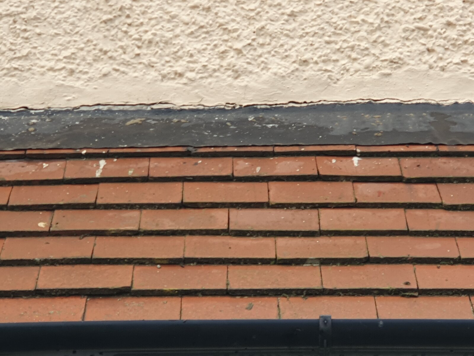

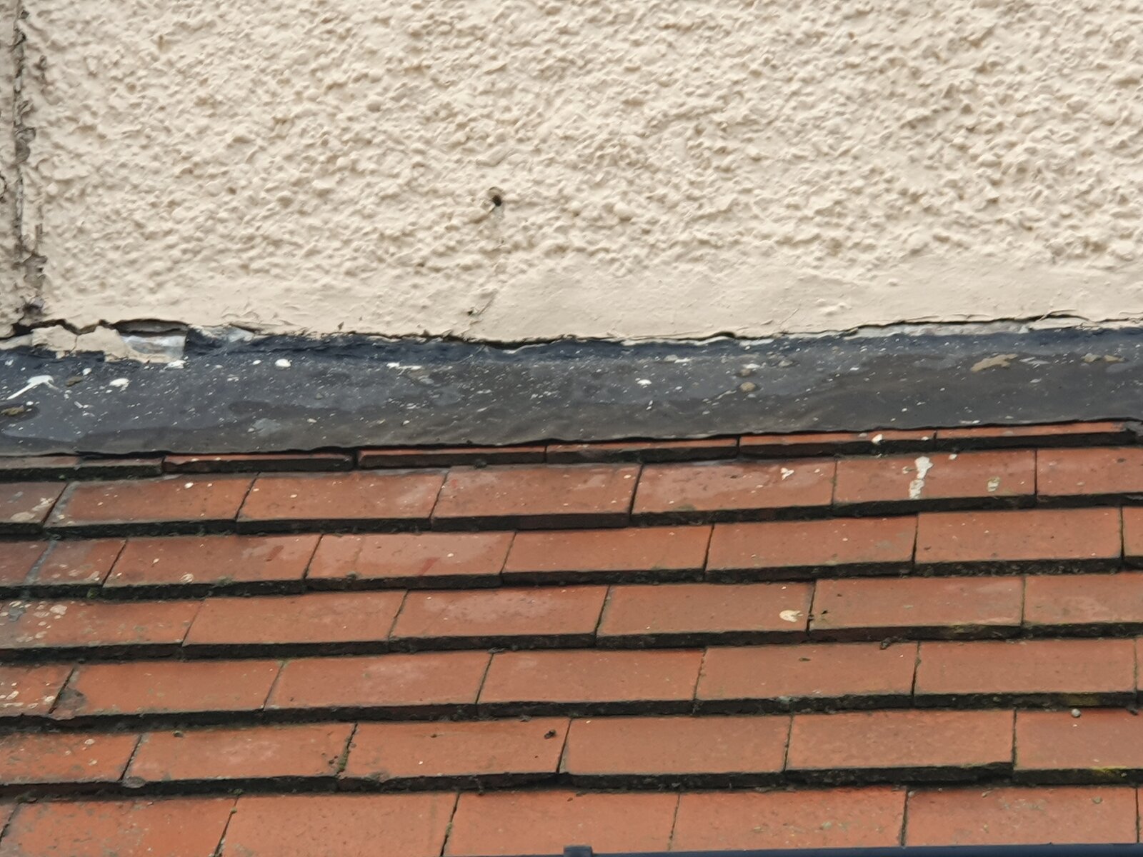

I have just seen my lead job on the bay window has detchaded from wall. Look like previous owner didn't make a good job.
As this is on semidetached side what would be the best things to do to make a long lasting job?

Looks like most of it is ok, I’d guess the gap is the mortar repair rather than the lead.
The bit on LHS of left image looks a bit ropey, it might be best to cut a section of say 2 foot, re cut the slot, then push in lead, dress down and use some lead mate to seal.
If you can’t get the lead to stay deep in the slot, then either use some offcuts of lead and bang in or get some lead flashing clips.
The lead looks quite old it might all need replacing, hard to tell from pics
OP'
1. The render immediately above the lead has been worked on previously. A Bell Cast should have been fitted.
2. The long single length of flashing has expanded & pulled itself out of the chase. 1.5m is the max length.
3. The lead should have been installed in at least two separate lengths with a 100mm overlap at the join.
4. Remove the lead & cut it in two pieces - a pic showing the full width of the roof/flashing would help?
5. The chase needs grinding out to a 25mm depth - the 20mm turnover should be wedged into the chase.

Looks to me like there is zero upstand on the lead. Any ex/con movement is having a more direct effect on the mortar chase joint, rather than a larger body (better shaped) piece of lead being able to absorb the movement.
Has the lead detached, or is it differential movement between two materials, with the weaker material (the render) having “split” from the lead? You could re render/ fill the gap over the lead and keep under review.
I think I'd look to cut a new chase further up, remove the render below the chase, and fit new lead if the existing cannot be repurposed. A new chase would helpget rid of the odd looking smooth slathered render at the bottom of the dash area
It looks to me that it has been replaced once before, probably 20yrs ago. If its not giving you any problems then fill the gaps the best you can, otherwise you will need to cut out the lot to make it look neat and not like a patch up.

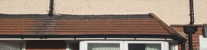

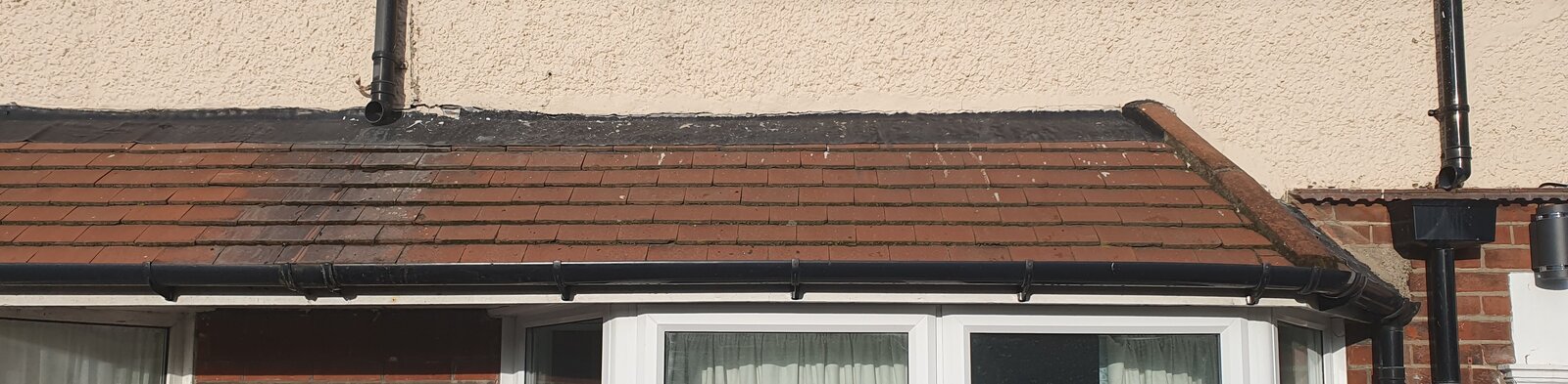

Full photos of my side attached
Doesn't look like a good job done previously.
I'm open to buy new code 4 lead and make job done properly.
Happy to hear how to do it.

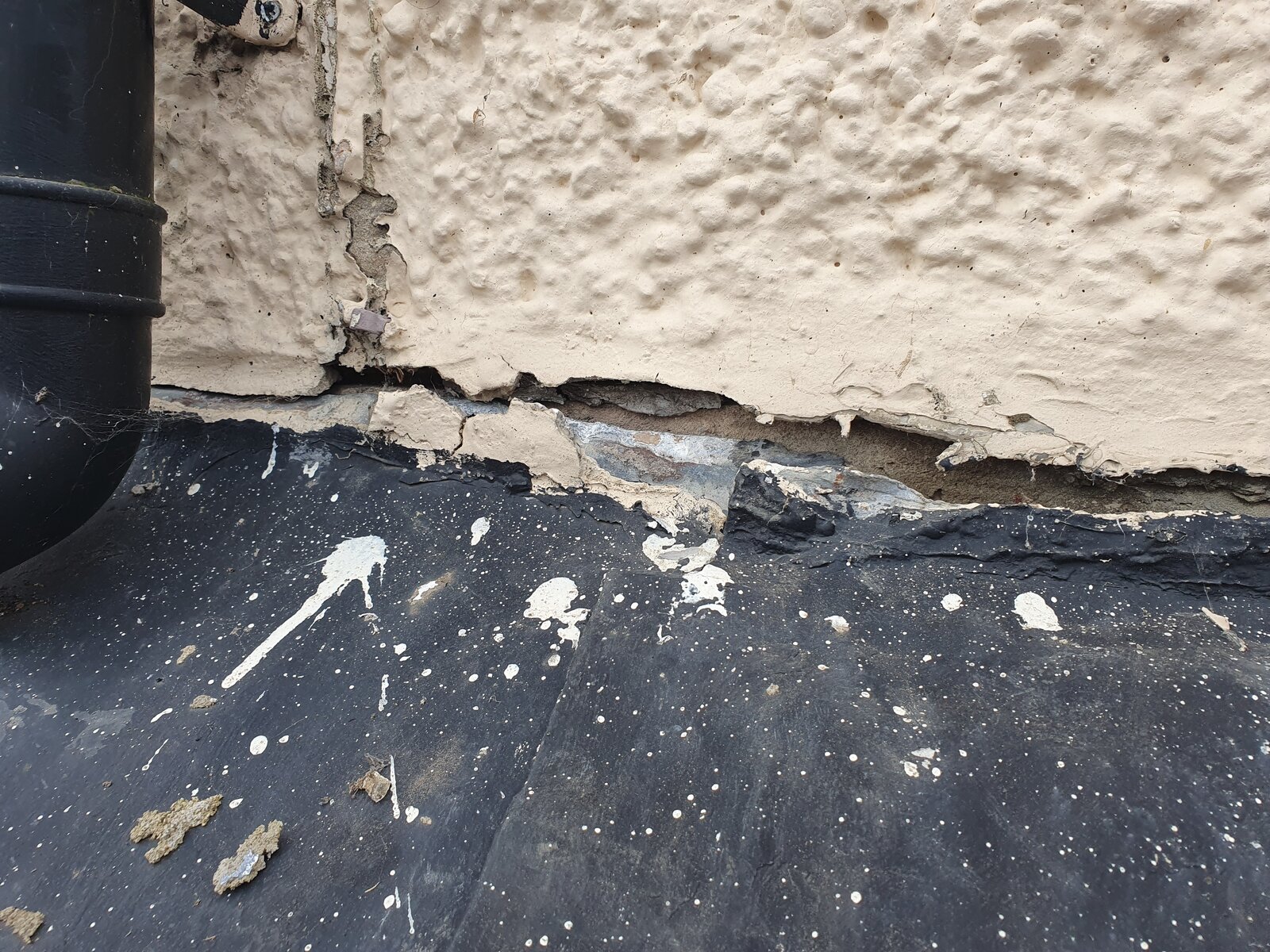

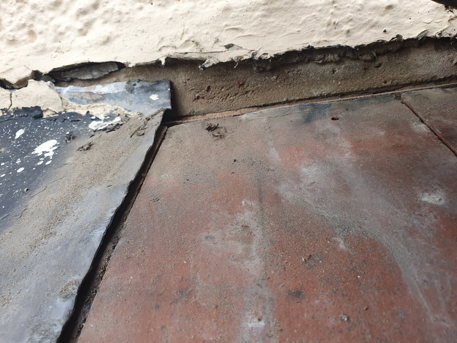

Yeah that close up shows it’s best to redo it all.
Cut a chase higher up, deep enough to go into the blockwork, you would probably need to chisel off the pebbledash render below the cut.
Then get a roll of lead wide enough.
You can use clips to hold the lead tight in the chase
Then use lead mate to seal.
