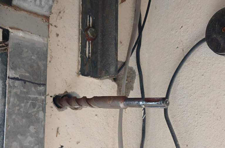

I've just tried to drill some small holes (like 3mm) for the screws and rawlplugs for the camera to go in, without success. It's like the bricks are made of cast iron, and the drill won't touch them. I've tried 3 different bits - and it's a 700W mains hammer drill, not some poxy cordless thing :mad:
And, studying the bigger hole I made with the SDS drill, I can see what happened - the brick split and fragmented, then the big drill bit jammed between a couple of the fragments, which is why I got smacked on the head.

Well, I've certainly answered my own question (the title of this thread). Believe it or not, I've been doing this sort of thing without major hassles for over 40 years - but with this (simple!) project, everything just keeps going wrong.
I've now been at it on and off all day, trying to drill from each end of the hole, to get them to meet in the middle. But the drill must have wandered off, as they're not meeting very well - though I can see a bit of light coming through from outside.
Actually... wow, there seems to be some sort of hardboard or something in the cavity, and of course a masonry drill won't have much effect on that, no matter how powerful the drill. And I haven't got any kind of conventional bit that long.
Anyway, eventually, I plucked up my courage and tried the SDS machino again - was really clever this time, and braced the main handle against the wall to my right, so it couldn't spin.
Of course, it got a fair way in, then jammed solid as before. Except this time the bit is utterly locked in place, and I can't get it out of the ******* wall, no matter what I try. Have put mole grips on the end and tried to turn it with all my strength, but no joy. And the drill doesn't seem to have a reverse action.
Any suggestions? Except throw myself off the nearest cliff - I've already thought of that one.

I am only guessing- perhaps whack the end with a club hammer. Hopefully that will dislodge whatever is trapping the bit. Then re-attach the drill and try bouncing it back and forth. Whacking whilst twisting simultaneously may also help.

Yes it does, but not powerful enough. Good thought though (y) Yes, I was working the bit back and forward - just there was a bit at the end of the hole that it kept catching on, I guess...
Yes thanks, did a bit of that, and more and more twisting etc - came out eventually.
Then I tried again, very very slowly this time - suddenly it broke through. And broke the f'ing wall :mad:
