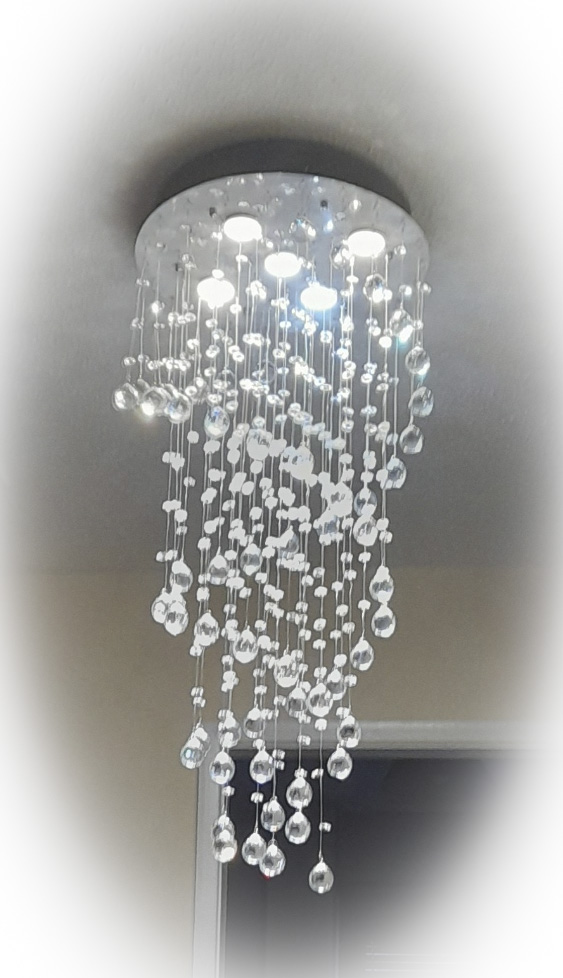

There are suggestions above to change the lamp base fitting to GU10. That would cost a few hundred quid and in some cases be impossible because of hole shape/size.
That does not ring true, as no need to change fitting, however running the earth may cause problems.

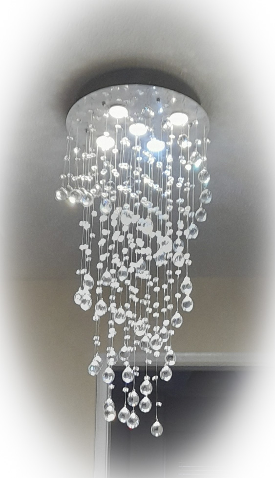

An "electrician" replaced the toroidal transformers supplying tension wire lighting in a picture gallery overlooking a harbour with compact SMPS units. Caused havoc with marine radio when the lights were turned on
The bulbs are different length, and the "luminaires" aren't mains rated, there's nowhere to put an earth. Rewiring would not be easy either.

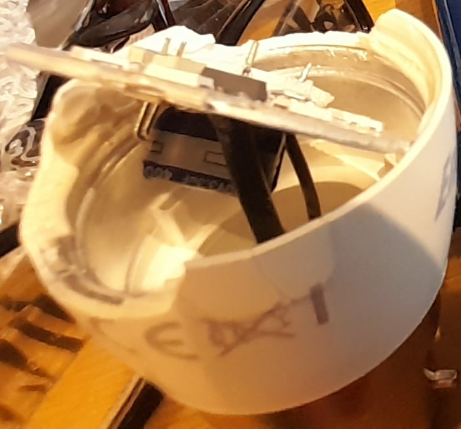

Er well, yes, that's what I'm asking. I have one of mine to saw/grind open.
I've seen circuits for BC sized bulbs, those have components you can alter if you can change SMD resistors. If you derate them a bit they do last longer, apparently.

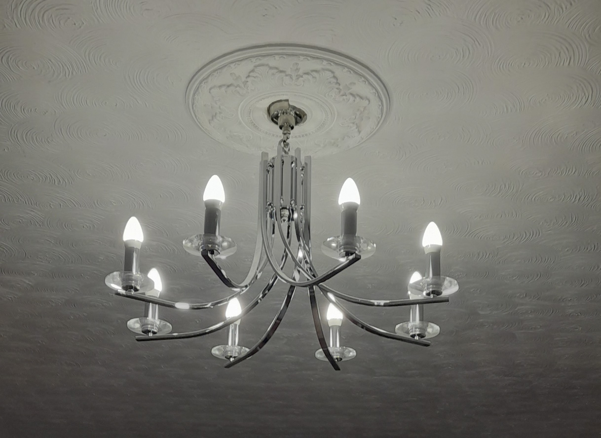

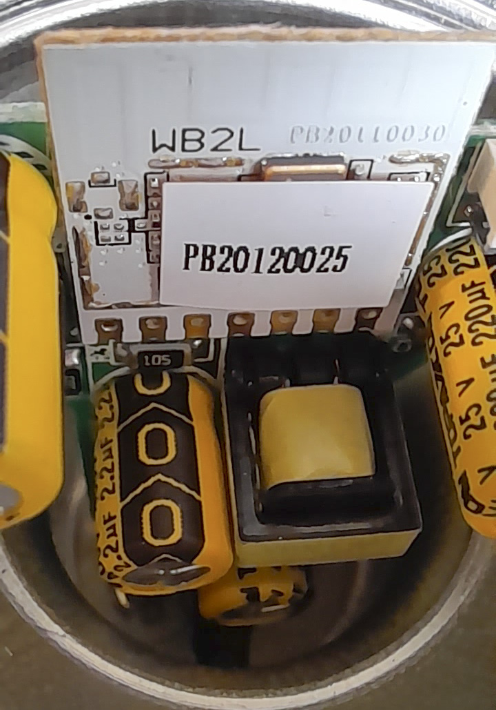

I have also opened some LED bulbs, only ones which have failed, but some really simple, others more like this 20220603_113820_1.jpg and until failed one has no idea which are which. But in all looking at around 6 bulbs in 6 years, I would not say that is a problem. OK when the fluorescent tube replacement went at around £16 I was some what peeved, and had one smart bulb fail at around £6, two were very early versions from PoundWorld, and one I actually found a dry joint and returned to service.
But I would guess around over 40 LED bulbs in the house, so 6 fails in around 6 years not really bad.
However my son has had more failures, so I have considered why, he does not have any SPD fitted, and he bought a batch of cheap bulbs from toolstation, he blames cheap bulbs, it seems the cheap bulbs I fitted before leaving the house are still working, also cheap, Home Bargains and Lidi, and all the 12 volt power with a toroidal lighting transformer.
I looked at the link @Justin Passing posted, and it is DC, and the bulbs I got from Lidi were clearly marked 50 Hz so designed for AC. I know sons house is low voltage just 230 volt, as it caused problems with the old 65 watt fluorescent starting, not really measured here.
I feel @Justin Passing is touching on the problem we are all having, lucky for me it was only one fitting, I have posted this picture many times, G9-comp.jpgboth G9 but the large one had a large smoothing capacitor inside, nearly as big as the small bulb, the small bulb was failing to switch off until this load-capacitor.jpgfitted, and then there was a shimmer when switched on, it did seem connected to the switch, light_switch.jpgwhich is electronic as we have no two way switching in bedrooms, so use these Remote control.jpgremote controls on bedside table. These have been a problem, did have 5, now down to 2, for many of my lights moved to smart bulbs, also used smart relays, but the problem is we are buying bulbs forced on us by the government, but there is no control over bulbs offered for sale.

I also looked at the inside of the bulb, and realised the GU10 and the candle bulb were nearly the same, both had a flat plate with the chips on, so hardly any light sent back towards the base.
With the bases on the bottom 20220415_000328_1.jpg and light reflected off the ceiling they seem to work well, but reverse it lamp-landing_1.jpgand it needs some thing to defuse the light, plus the heat goes into the bulb, the capacitor here 1664547886330.png is going to get a lot hotter if the base is above the plate.
