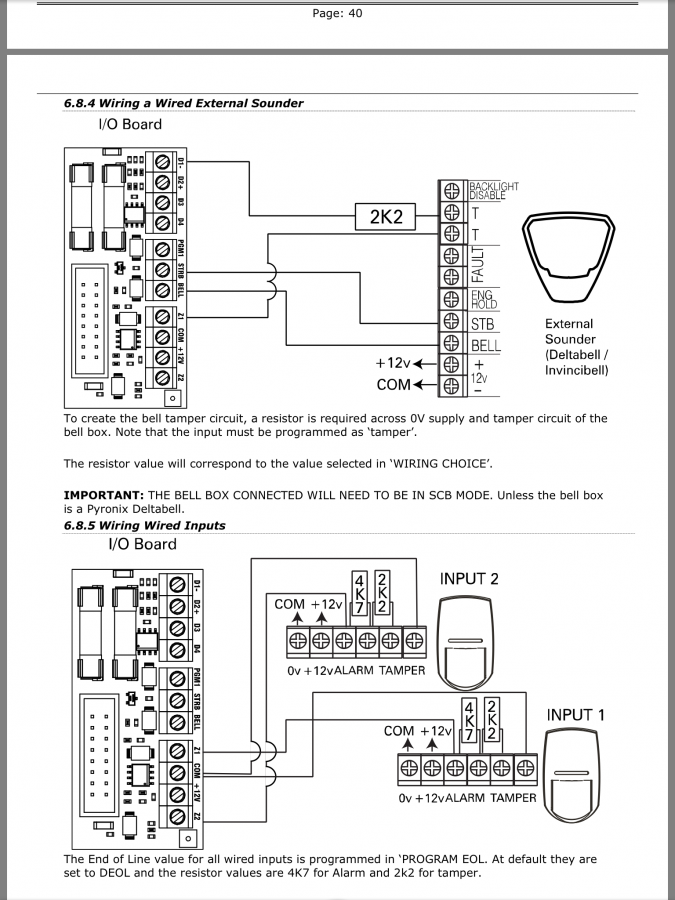

Finally in the new house. So am I still good for a Pyronix Enforcer doing a DIY install? Can I hardwire the wireless bell box? Anything I need to know before I purchase? Thanks!
No you can not hard wire the wireless bell box but you can wire a standard delta bell box using the outputs.

Pics not showing my end. I thought as much regarding the bell box. I'll have to phone Map security and see if I can swap the bell in one of there kits. Regarding the programming, just double checking really, does it come with any instructions? I'm a gas engineer so not totally useless but no alarm installer at the same time.
You will also need I/O board to connect to control panel to allow you to wire hard wired bell
