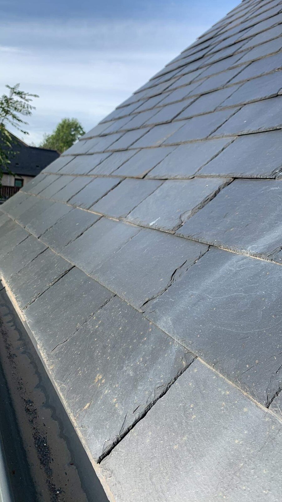

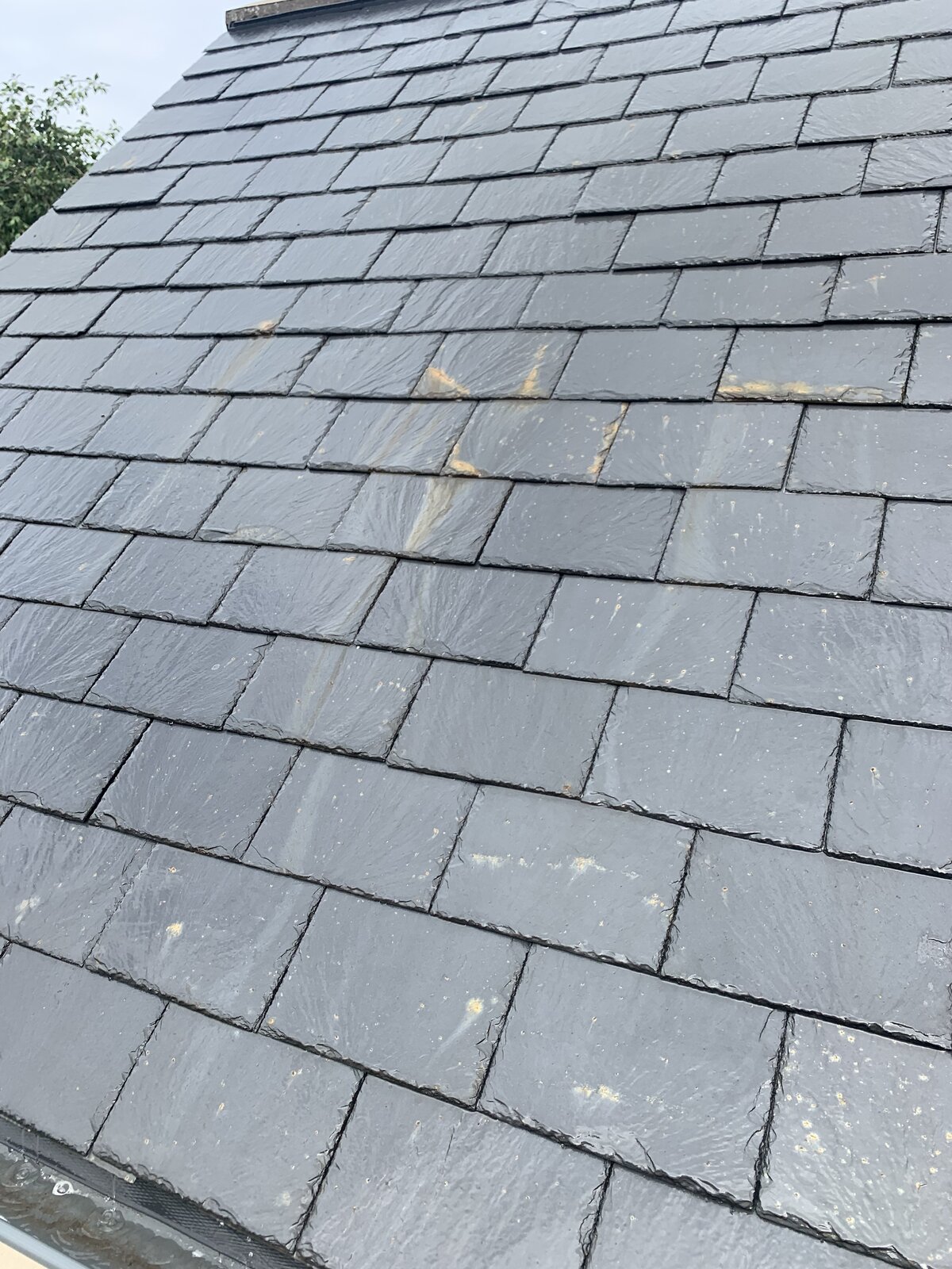

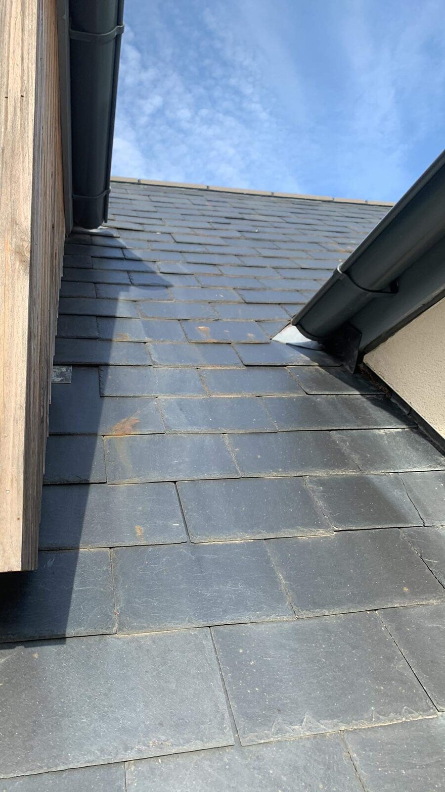

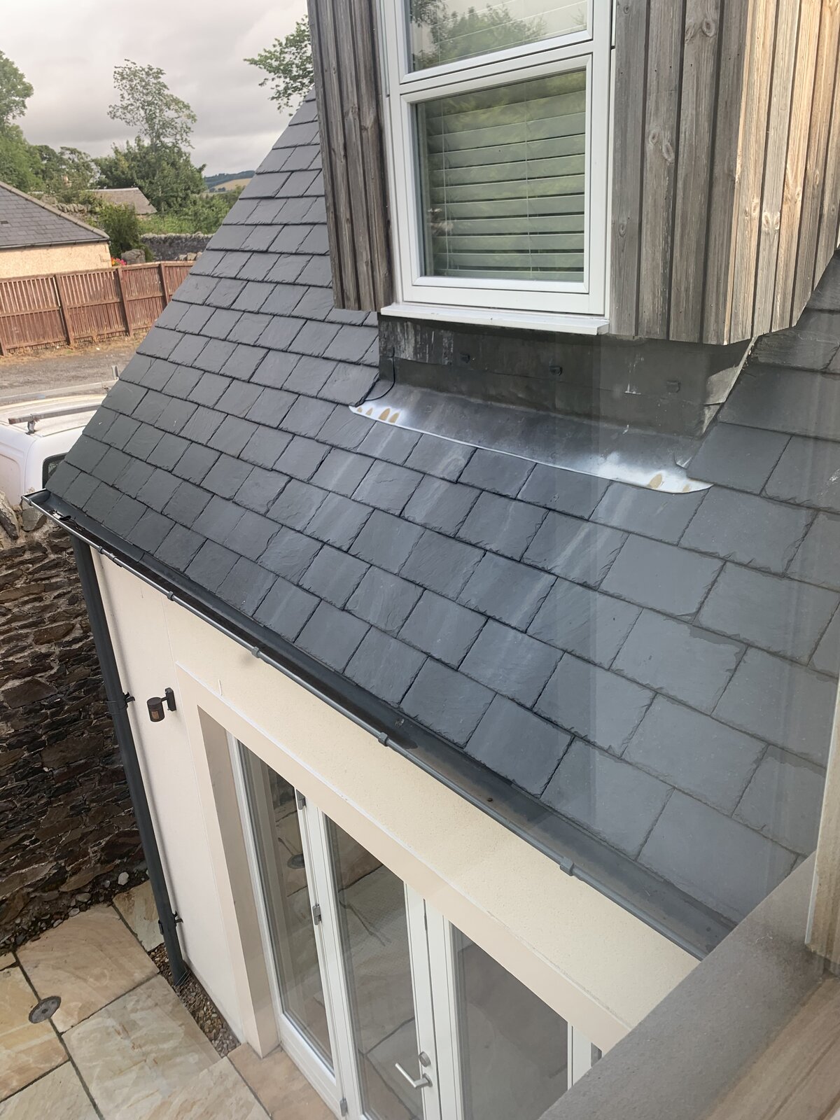

Had a biocide roof clean done by a local contractor around four months ago, and had a few problems since. He done the job with spraying method.
The lead started streaking down the slates within a month, and now our slates have started rusting/have rusty spots all over.
The house is only five years old, and had no problems prior apart from some algae.
He is not answering any calls, and has since moved away from the area. Are our slates ruined?

Your slates are fine, they are just a cheaper quality slate. The rust will happen now, nothing you can do except replace them.
The lead is an issue, whatever they have used is reacting with it badly.
Cheap slate, rusting pyrites..
Lead run off maybe it was not oiled after fitting .
Fyi the rusting will get worse and eventually form holes.
The slating is pretty rubbish too , and slate missing next to dormer
