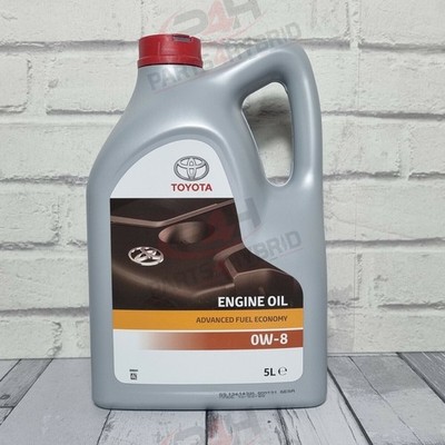

Curiously, the recommended oil - far from being the traditional 5/30 C3, is in fact 0w /8. Never heard of that one but I can see why it needs to be so thin.

I couldn't find a local supplier with stocks. I like to keep a litre in the boot. The price is ludicrous. The manual does say that if unavailable, you can top up with other grades but you should use the recommended one at oil change.
It might be for the fuel economy ratings though rather than engine protection.
