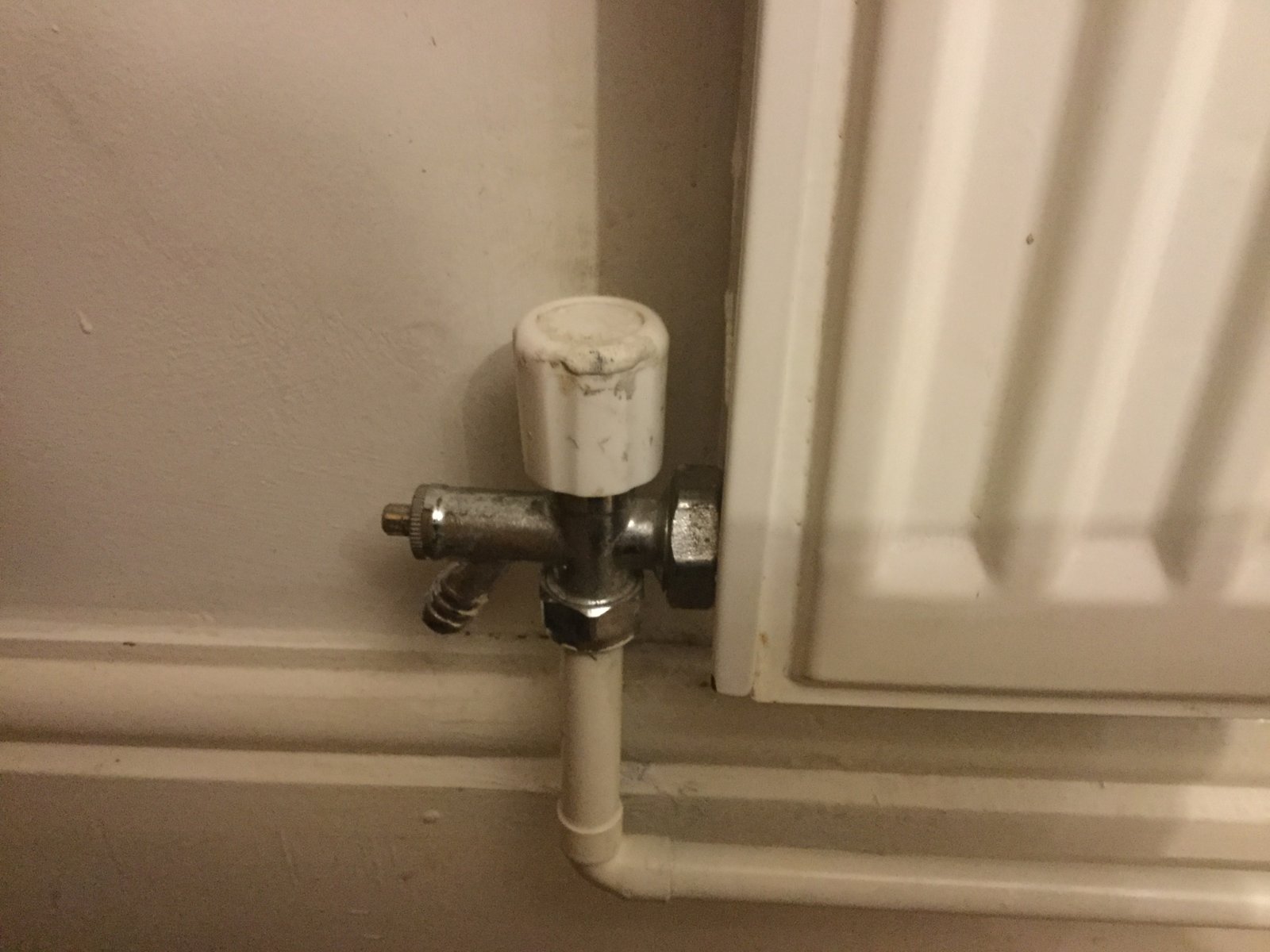

Blocked central heating pipe
If it is a blockage in a pipe it could be either the flow or return to rad.
The fact that the flow pipe gets very hot is normal in a nearly blocked circuit, but can still be the flow pipe blocked.
Good chance the pipes could just be simply flushed out from each rad valve of that rad.
The pipe blocking is perhaps something that is just a risk of happening in an old dirty system, so I wouldn’t entirely blame the boiler installers (if they correctly did a chemical flush).
But I would have thought the company would have came back FOC to try to sort it.
Out of interest, - did your last engineer try to run the valves into a hose to check flow?
Chemical Flush
This may be a bit daft, but weird things get missed. Try to remove the valve cap from the other valve. You may need a small screwdriver, or if no screw visible on top it pulls off. Once off, use an adjustable spanner and turn the spindle fully ANTI clockwise. Count the number f 1/2 turns until it stops. Try heating. Report back :)
The valve was already fully anti clockwise and can’t go any further. Now I have turned the heating down to 20 and turned the radiators back on, the radiator in question is luke warm at the top and cold at the bottom.
When you say valve you mean this?

If I was there,I would be turning off valves, disconnect and run water into a container, just to see flow. Quick swap of valves and try again. Just to eliminate valves from issue. I would bet against sludge causing this, TBH. But then, if I was installer, I would have returned to sort out, not to sell another job.

Are either of the pipes hot to it? Did the TRV get changed? Have you tried to removed the head?
