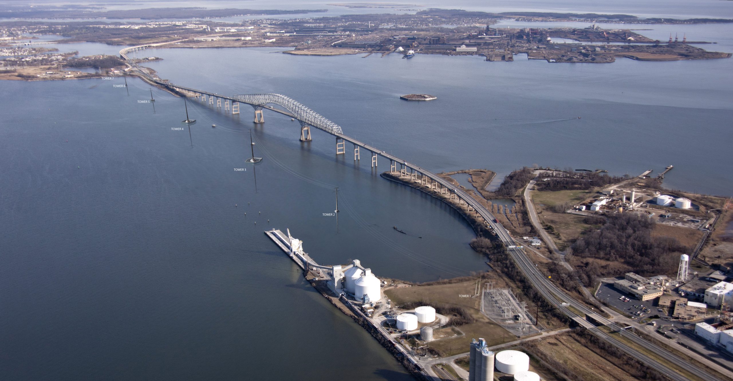

but given the depth in the area, a bit of banking or breakwater around the critical pillars would have caused a grounding rather than total destruction.
Bearing in mind I still know nothing about ships! There have been a couple of mentions on this thread about a "channel". I'm guessing this is what they use a dredger for? Could they have avoided this disaster by dredging in such a way that the ship would have run aground if it had strayed too near to the bridge?
More the other way around. Bridge designers tend to install the supports in the shallower water. But in this case that would not have been possible.

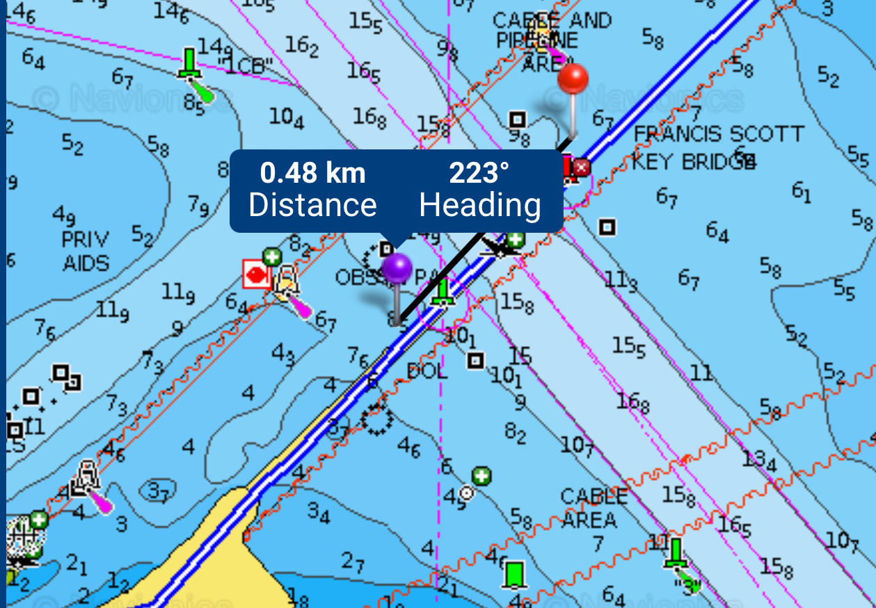

It’s a wide channel. If you go to navionics and look at the chart viewer. You can see the span and depth. You will also see the overhead power/comms cables are protected. A few dolphin piles strategically placed would have done the job. We aren’t talking millions.

The towers in the deep channel are protected with collision prevention “fenders”. Think retaining concrete walls around the towers with bumpers attached.
Ships and boats have been dealing with night time / poor visibility for years.
1. Everything is on a chart
2. The towers / banks will have a navigation aids / light sequence (also on the chart). For example these have a light that has a sequence of 4 quick white flashes.
3. Everyone has radar.
