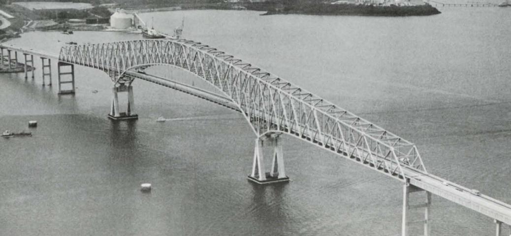

The Dall is 91,000 tonnes. Typical big container ship ~230,000 tonne. This is what the bridge did look like. It's classed as a long span bridge, One of the longer ones.

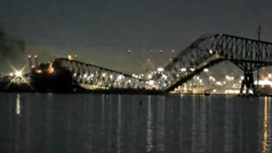

Frame by frame video of the collision.

However, engineers have told NCE that it is unlikely that the bridge’s condition would have been the cause of the collapse. A bridge of this type would not have been designed to withstand loads such as that applied when the ship struck its pier, according University of Sheffield department of civil engineering blast and impact dynamics research fellow Andrew Barr.
Barr told NCE: “The video doesn't show any obvious structural deficiencies with the bridge, but it will not have been designed to survive a head-on collision with such a large vessel. Bridges in shipping lanes are sometimes designed with strong, stout piers, or additional protective structures around the piers to prevent ships from coming into contact with the bridge structure. It doesn't appear that the Key Bridge had either of these features, although it is also very likely that the size and design of the vessels passing under the bridge has changed considerably since it was completed in 1977.”
Institution of Structural Engineers fellow and independent bridge consultant Ian Firth said: “It is almost impossible to design a bridge pier to withstand this kind of impact. Therefore, we tend to design impact protection measures to prevent it from happening instead.
“Dolphins or other vessel impact protection devices in the water are commonplace since the Sunshine Skyway collapse in 1980. But this bridge was built in the 1970’s, so the design would not have incorporated these devices at that time. The fact that a vessel can veer off course and hit the pier is the reason to design vessel impact protection systems so that a large vessel cannot hit the critical bridge support.
dont they tend to build islands with shallow sloping sides in front of supports so a big ship would ground and halt before hitting the bridge columns
the bridge that failed had 4 column supports -and as soon as the ship took out one of the 4 the bridge was coming down
