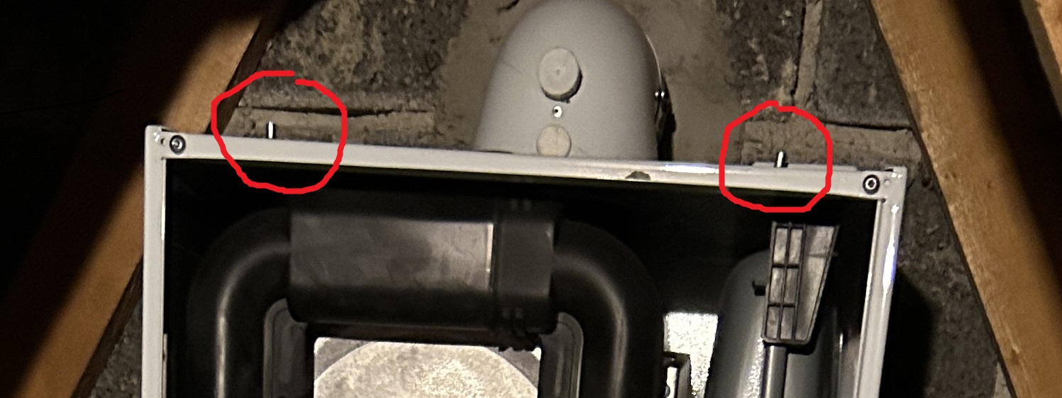

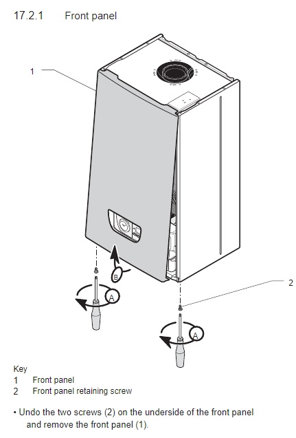

After further investigation it seems like a few of you were correct! The lugs on the top are not spring loaded. So, I removed the torx screws on the bottom, bent the metal tabs back into place (I originally thought it was hinged!! Good job the table was in front otherwise it would have dropped all the way down and probably snapped the tabs off!!), I slid the panel over the lugs and the panel popped straight back into place. Re fitted the screws! All good!! The only thing that could have possibly happened, is a while ago I had to have a part replaced (covered by British Gas!) The 'engineer' obviously didn't latch the cover over the top lugs? There is no other way it could have come off. Impossible!! I am still going to get it checked over anyway as it's due a service.

Simple to be sure, (s)he should have been certain it was properly latched. Best report it back to BG, as a fail, and maybe ask that they re-attend, and check it for leakage/ that it is safe. Refer them to this thread.

It's so simple - you ease the case lugs, over the pins, you waggle the cover to make sure it has properly latched, close then fit the two bottom screws. It's completely inexcusable to not getting it right. The engineer who got it wrong, should be handed his/her P45, for getting it wrong.

How do you know that the top lugs on the outer cover were not out of shape such that they just engaged the tip of the pin. Boiler not serviced, electrodes now causing explosive ignition, cover gets blown. I have seen results of explosive ignition, it can distort metal with ease. Top of the case could succumb to such ignition I suspect
