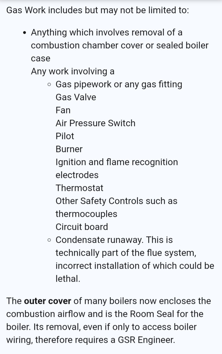

Although I agree with your sentiment, there is also a distinction to be made.
Whatever we consider to be acceptable work for a DIY'er to do, we should also abide by the forum rules on DIY gas work - which amongst other things, specifically mentions the outer cover...
As a professional (although not in this field), I personally, will give advice based on these rules.
Which may mean advising a DIYer against removing the cover of a room-sealed boiler, without getting it checked by an RGI afterwards.
When these type of issues come up, the forum rules almost make it a duty to mention competence etc.
