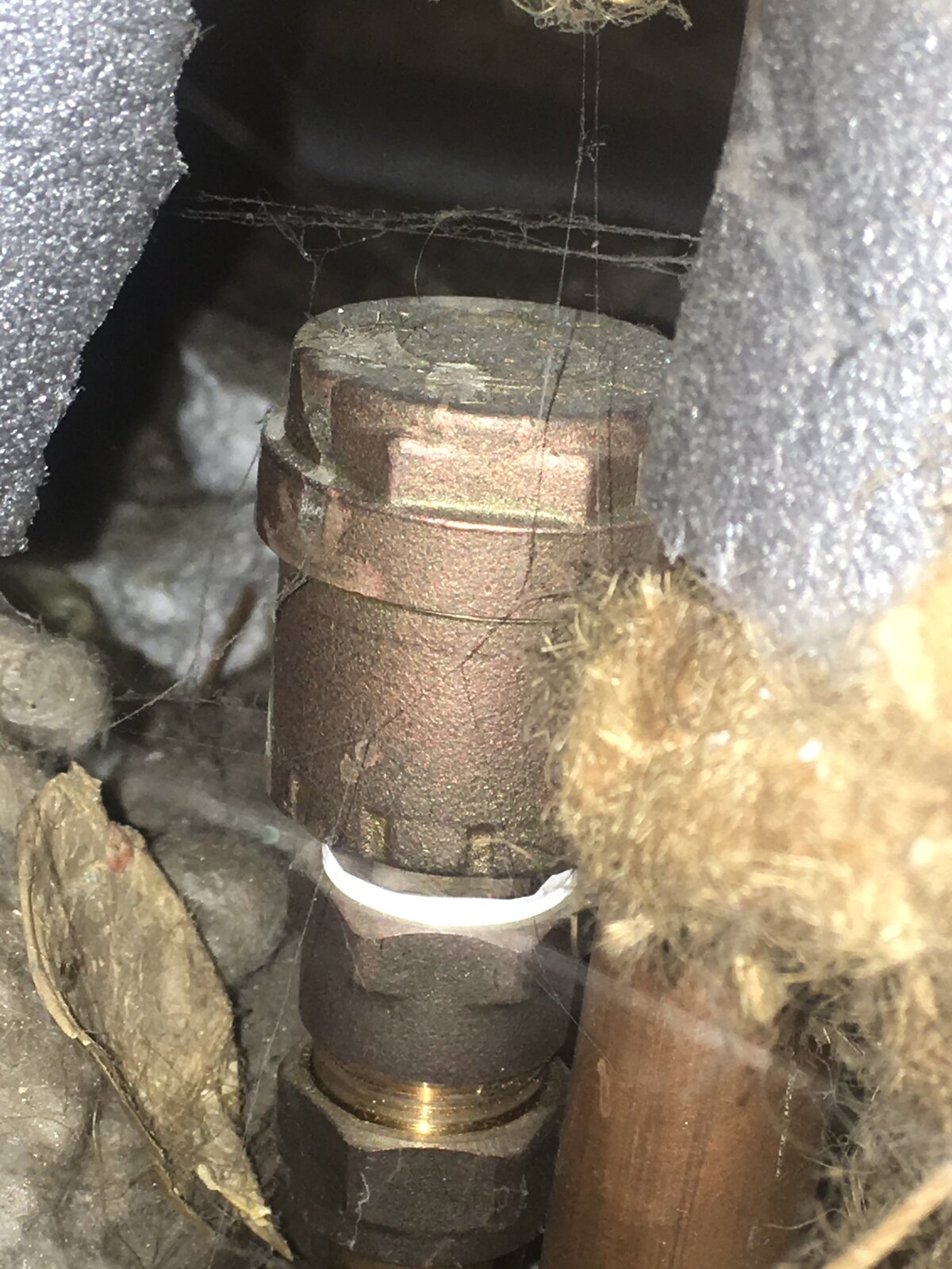

So I went into the loft to tie the ball cocks up and started think more about where the 15mm pipe that sprouted off valve B went, after moving lots of insulation I managed to find this (pictured below), could this be a bleed valve? How does it work?
It’s pretty much butted up to the pipe next to it and in such a horrible location I don’t know how I’m going to get to it yet. But if that is what I need I will find a way.
It certainly looks like an automatic air vent ,is there a bit that sticks out from its side ,or near the top out of view ?
If it is an automatic vent ,it may not be working !! There are many different types of auto air vents ,I personally don't recognise that one , as I can't see the bit that usually sticks up ,either from the top or out the side near the top.
I have just managed to get closer and there is a bit sticking out, I had a little fiddle and the bit sticking out is very loose and can be turned with the fingers. I didn’t want to twist it to much though incase I caused any damage
That cap should be loose. That's where the air can release from. You can remove the cap,below is a bit like a car tyre valve ,where air should come out of the air vent until water level rises high enough to seal it closed. It can't be working properly if it's not releasing air out the system.
just slacken the nut untill water comes out then tighten it back up again
