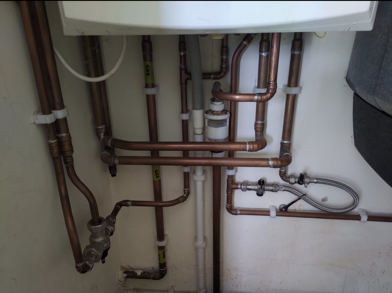

You should be able to isolate the boiler using the valves on the bottom of it. Try the cold water inlet on that first and see if the dropping stops. Has the heating pressure changed?
I have looked under boiler at all pipes and can not see anything to isolate boiler. There are no taps underneath that I can turn off and not even one of them valves with a screw under that You can turn to turn off water. I've searched every pipe in cupboard.
None of pipes have anything. Only way I can see to turn water off is to turn mains off at a tap in cupboard under kitchen sink. This turns off cold mains water to whole house.
It's kind of strange, I did expect there to be some kind of cut off for water near boiler. Seems silly to me that there isn't.

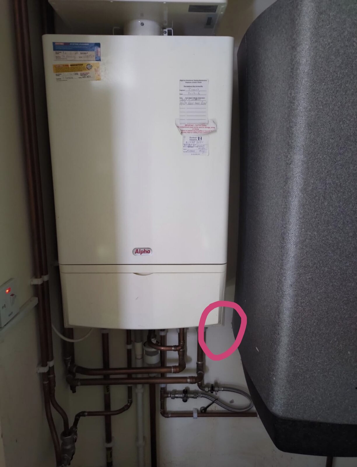

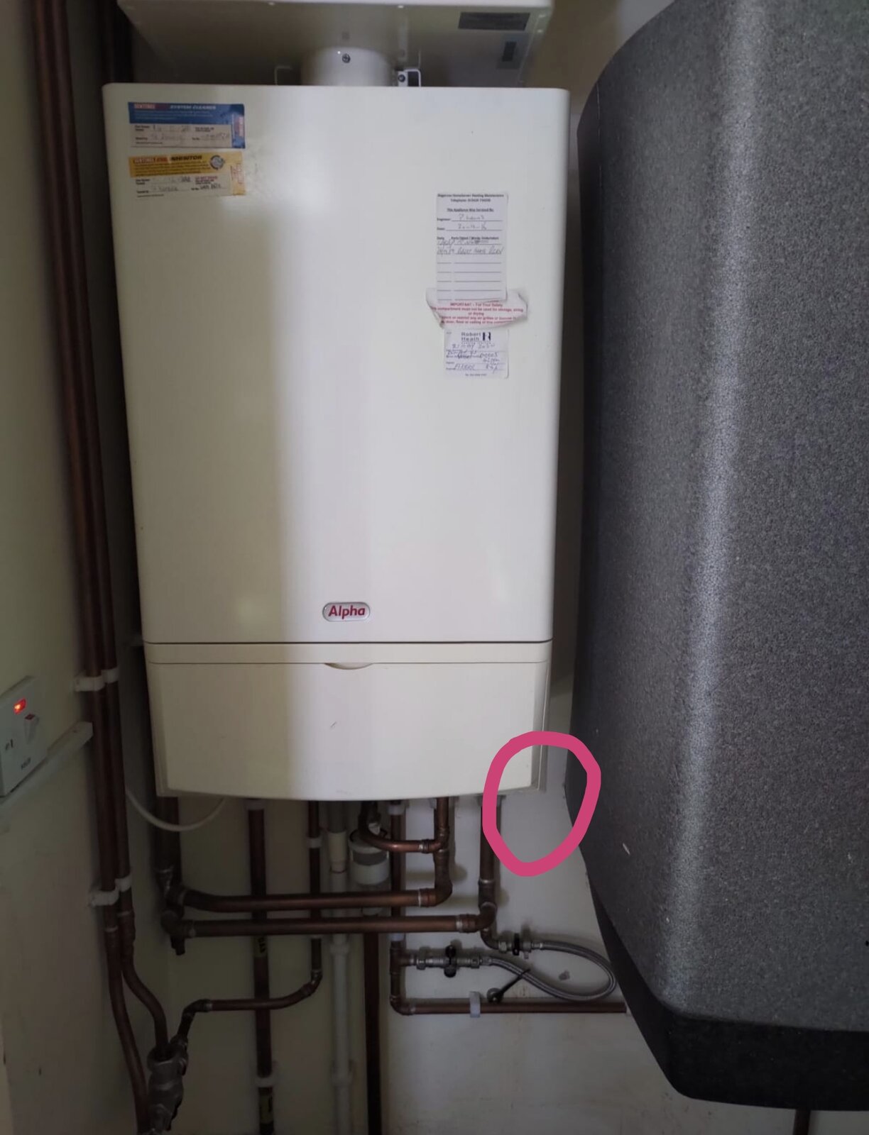

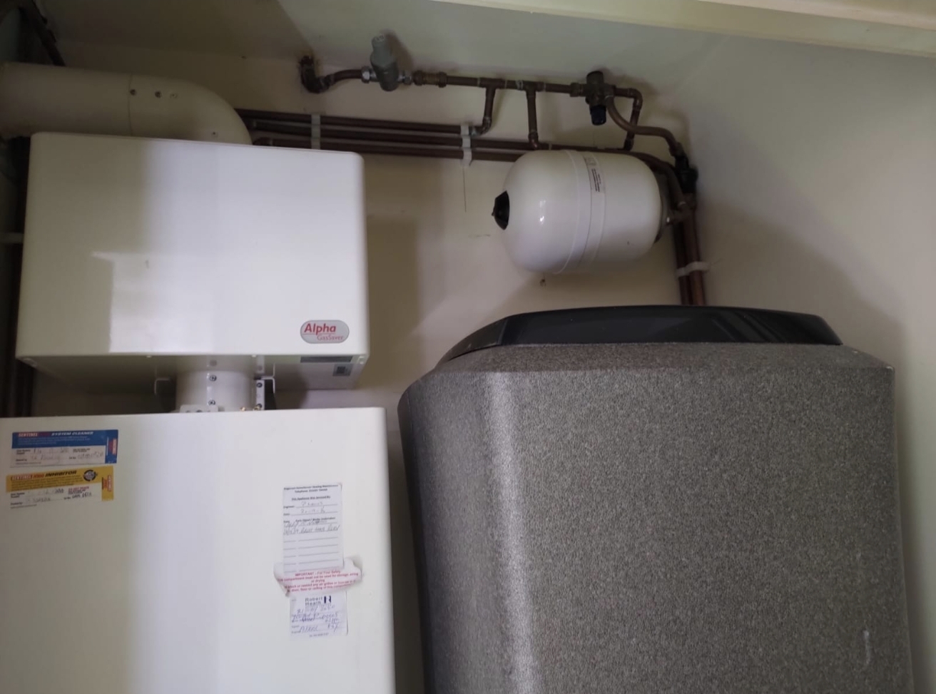

Sorry if pictures are not great. Where I've drawn a red circle is where water is dripping from.
I hope you can see the pipes ok.
There are a couple of things that look like the could turn on pipes above but they don't seem to move and are on pipes heading upstairs.

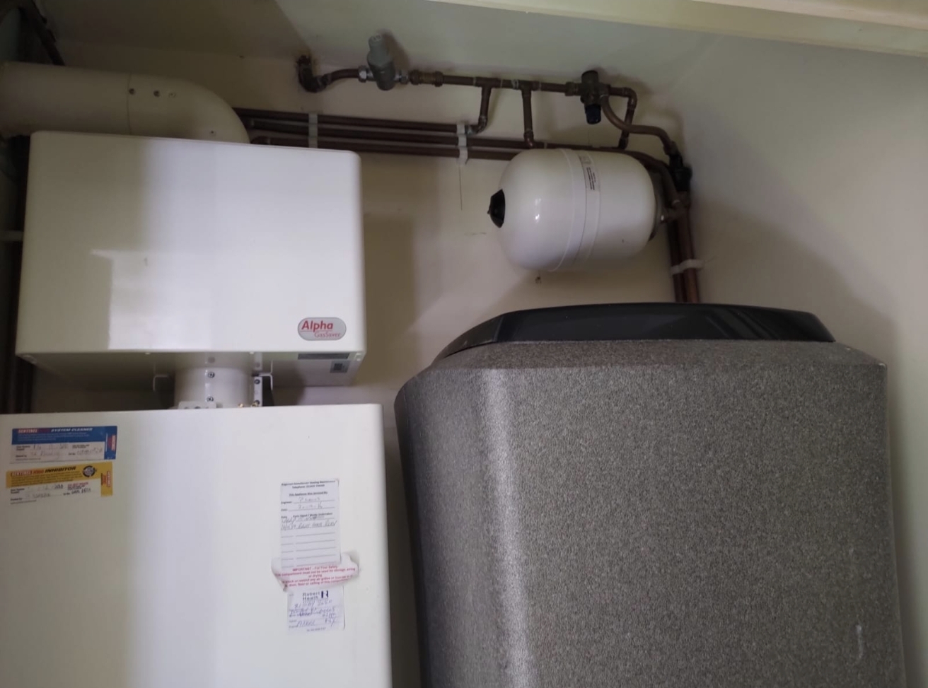

Above is upstairs bathroom. Like have said boiler is connected to a solar system. Grey tank next to boiler is water tank for solar system.
There are pipes that go from this tank upstairs and to loft, then straight to solar panel, water or some liquid then flows through solar panel where it's meant to be heated up by sun then it's sent back down to tank to warm water. Boiler heats up water more using gas if water isn't hot enough. Hope that makes sense. There is no water tank in loft. Only thing in loft is pump plus solar panel on roof. Only tank in house is grey one next to boiler.
Hope this helps you understand layout

What area are you ? Do you not have a contact list of tradesman you can turn to in an emergency ? Or local family and friends. Sounds like a leak on the cold feed to boiler. Usually a valve on the underside of the boiler to isolate. Then open hot tap to kitchen sink and drain / let pressure go. Residue water may continue a little and then stop as you have isolated the source at the boiler. If you call out an emergency plumber, you can be billed high.

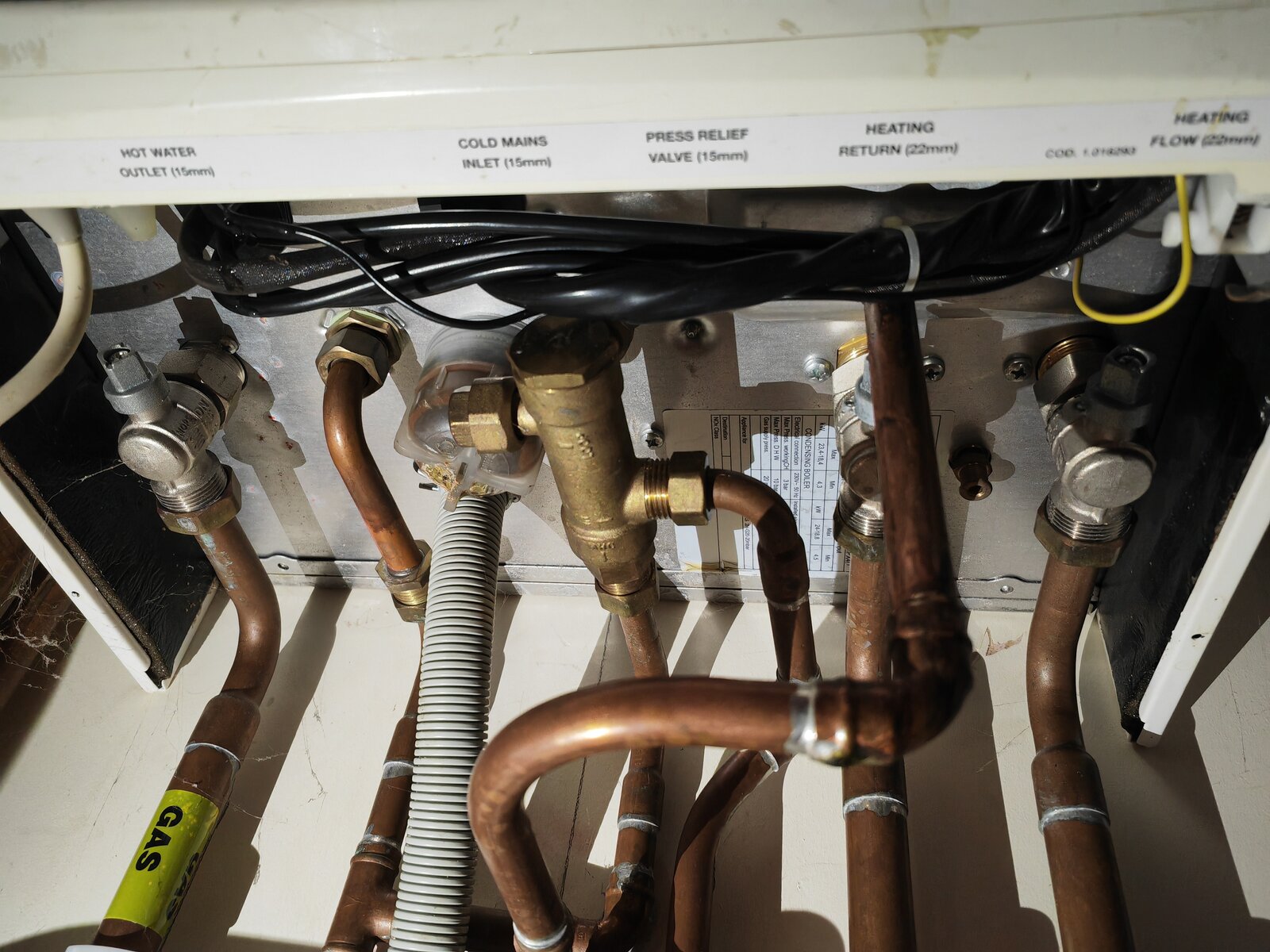

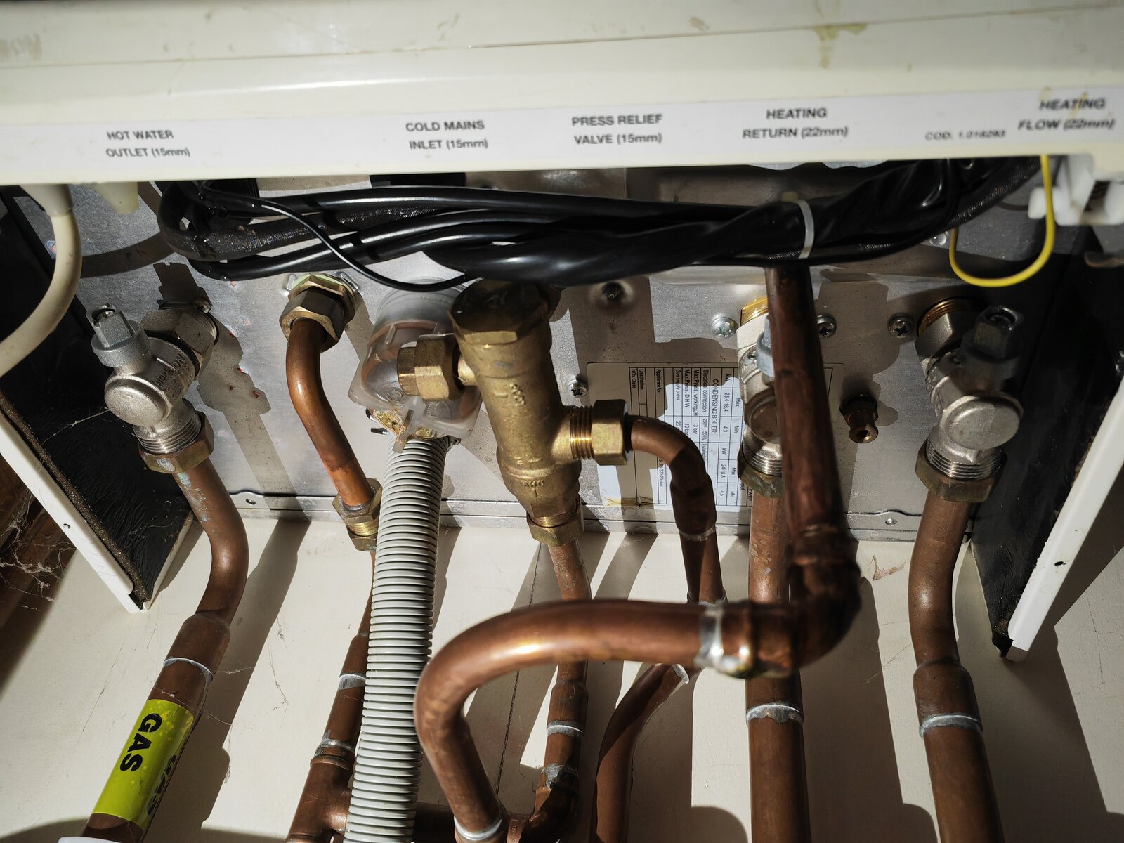

Here is a photo of underneath of boiler

The housing association would most likely assess the problem and isolate the leak. Then leave you with temporary heaters. Parts likely need to be ordered and time for an engineer to fix. As you have young children are they not obliged to attend ? Maybe escalate the complaint.

Also just out of curiosity more than anything, should there be a isolation valve under boiler to stop water to boiler in case there's a leak? Is there any legal requirement for a isolation valve for mains water to boiler?
I was speaking to a friend who runs a building business and has alot of knowledge of boilers. And he reckons it should never have been signed off without a isolation valve to stop water to boiler in a emergency. Sadly he doesnt live near me or would have come over and had a look.
He says every boiler they install they put a isolation valve under boiler to turn off water to boiler in a emergency?
