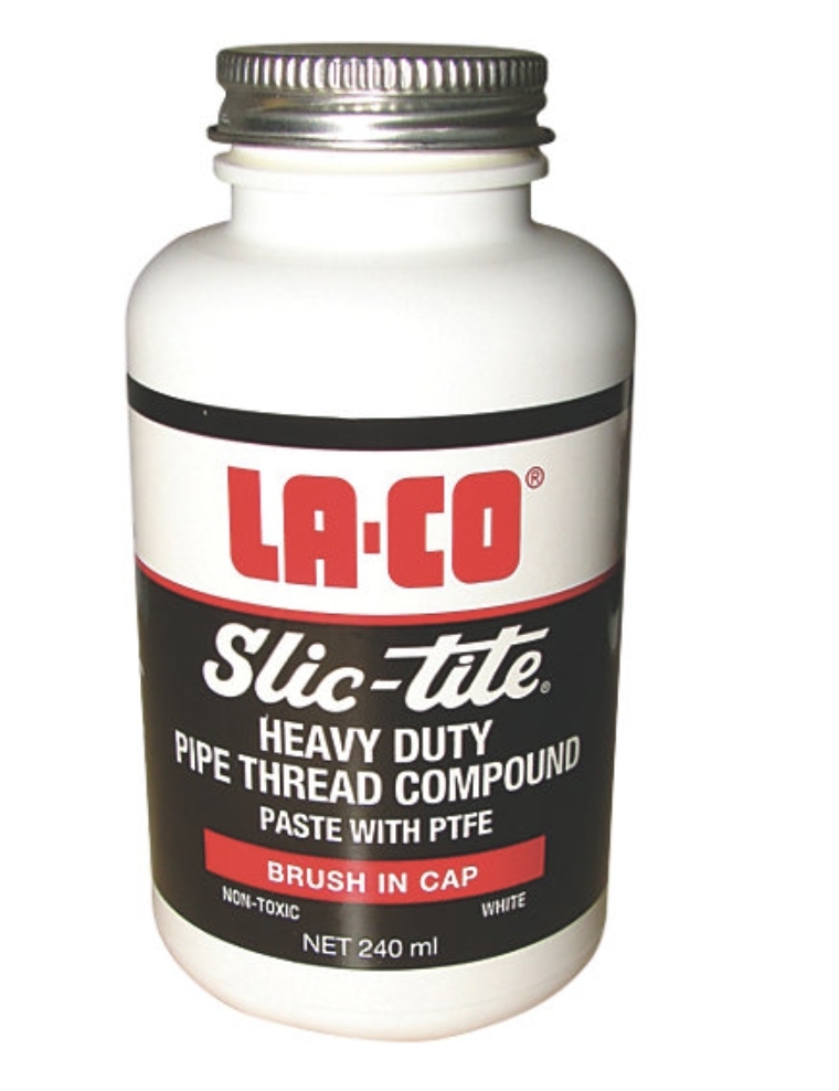

Boiler leaking water Urgent advice needed?
I was just researching and I believe what he put on washers was actually LA-CO Slic tite Heavy duty pipe thread compound. Pot looked identical to this.
Is this bad in boiler could it have blocked the mini heat exchanger or DW heat exchange?
