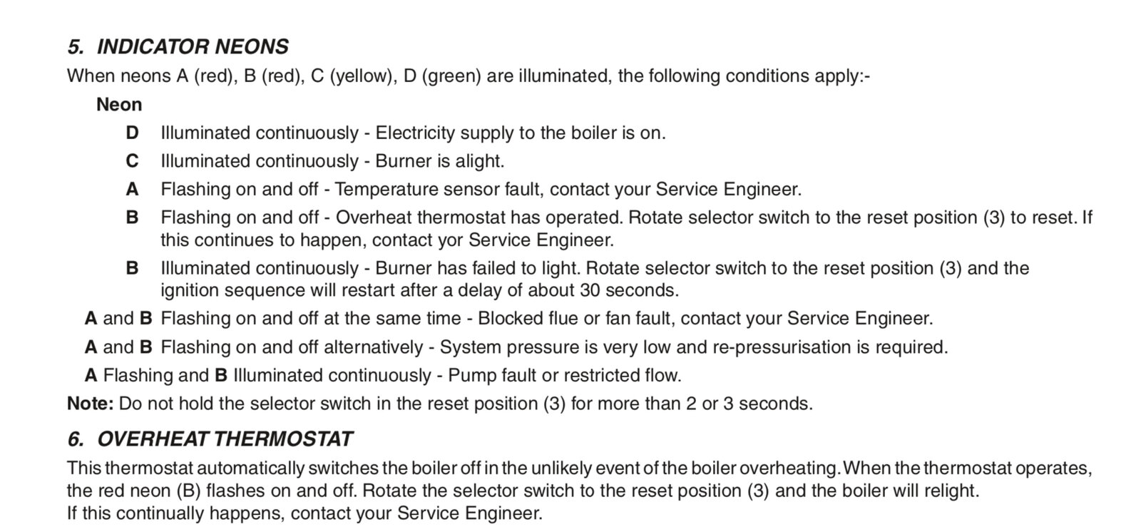

Went over and lights A, B and C are all going on and off at same time. A and B are red lights C is a yellow light. D light is green and staying on continuously.
Now I have no pressure to hot taps, no hot water and no heating.
Any one got any idea what he has done or what the lights mean

The boiler has locked out so it won't do anything until it's reset. Rest is position 3 on the selector knob - go for 3 secs

Really difficult for any of us to diagnose over the net unfortunately, all 3 lights blinking is a lockout and would usually respond to a reset, is the system pressure ok?
There is nothing inside the boiler that would physically stop the hot water from running, it's a combi so running off the mains so wouldn't normally suspect an airlock. If there is a little flow from the HW outlet and then it stops each time you try then that's more than likely a blockage, if he used some type of sealant when fitting the washers then I would suspect something has got in a blocked it.
System pressure seems fine it's in the green and hasn't changed. I appreciate it's hard to diagnose over net without seeing boiler.
