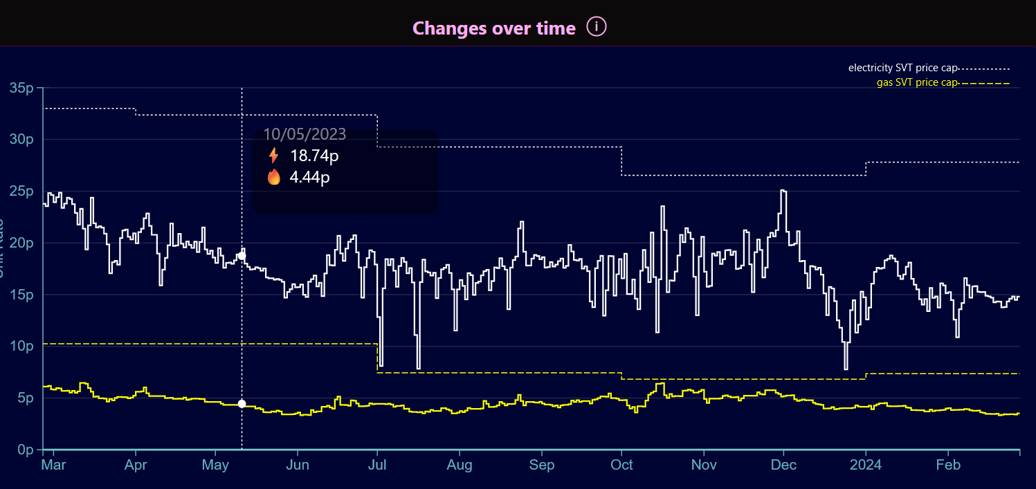

Here is what I am paying, at the moment for my energy, on Octopus's Tracker tariff...
The upper line is the cost of electric, the price those on a variable tarrif are paying to most companies. The jagged line below, is what I am paying each day for mine. The third line down, is what most people are paying for their gas, below that what I actually pay. In both cases, a great deal less-most of the time, though the actual cost varies from day to day.
