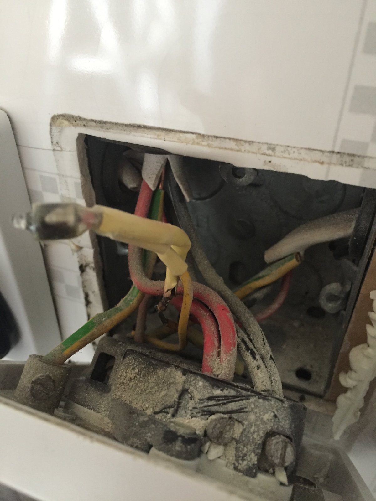

Just removed the switch from wall and found this...looks like the switch red light indicator has burnt out and taken the wire with it and scorched the wire insulation. In the state shown in the photo the boiler is staying on...at the moment!
That burnt wire may have been the cause, although not necessarily.
The dust/dirt on the wires won't be helping either.
The screws on the top edge as shown in the picture are live even if the switch is off.
The whole switch needs to be replaced, and power to the circuit (or house) must be turned off first (using the RCD that trips).
A neon is optional, and the fuse in the new one will need to be changed to a 3A type, as they are supplied with 13A.
Looks like the likely suspect. Change it and then next step is to see if it cures the problem. You could also, in the meantime take the fly-lead from the pump and use that to power the boiler - with a 3amp fuse in the plug of course!
