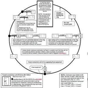

This chart
shows generally what is permitted. As to who can fit what, it depends where you live and what room the boiler is in. In Wales where I live wiring in a kitchen needs notifying so often the plumber will not touch it, England, Scotland and Ulster all have different rules. And the laws are not very well written so there is some debate as what can and can't be done.
