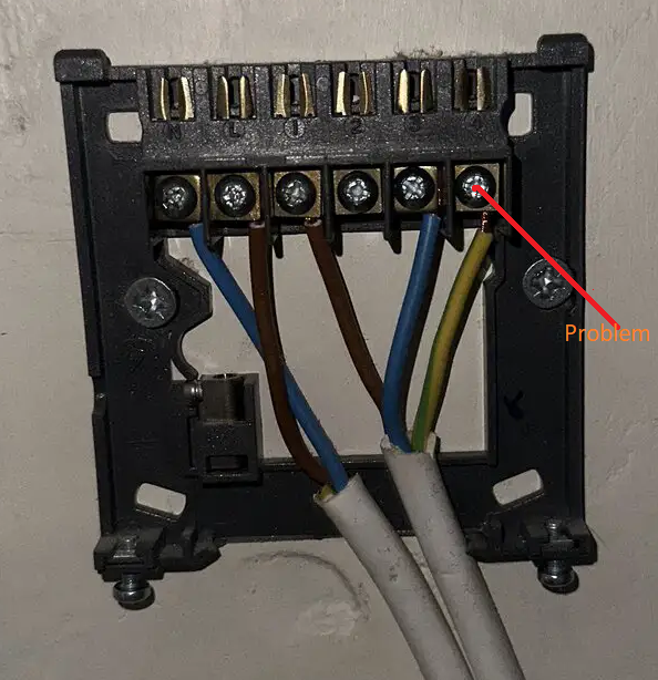

On another post today 1702496337518.png this is typical of Plumbers doing electrical work, and if you don't inspect and test, then the fault becomes yours.
