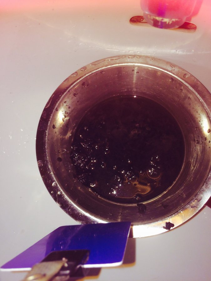

Thank you so much the stop start issues were driving me batty! As others have said, found the "secret" flap, cleaned out the slimy liquid, and now my dryer is back to as new performance. So pleased I found this site!:D

1000thanks for the advice of that darn dryer! I used a nail file to get the secret compartment up.

Just managed to sort the issue out. I had container full light coming on all the time on Classixx 7. I guess most models have same setup so good luck.
You need two torx bits or torx screwdrivers size tx15 or tx20.
Remove top cover removing two back screws, slide backwards and lift out.
Next thing is to remove the left hand panel (as you are facing the machine) or the nearest to the wastage tank. Remove screws from top, rear, one screw at bottom and then remove waste tank, u'll find 3 screws, remove and pull the plastic panel towards you and let it rest on screw on right. you'll hear uncliping noise but it's fine. U'll reveal couple more screws holding left panel. Remove them.
Once all screws are removed you have to slide the panel backwards by prying off from front side. Remove panel.
Now u'll see a black hose and a white plastic pipe connecting the pump at bottom rear corner. Firstly remove the plastic pump cover to gain access to pump(one screw and press clips from sides, lift up). Then disconnect two wiring connections to pump. U'll find a clip retaining the pump next to wiring securing clip. Unclip and slide pump forwards. Remove the pump and clean all dirt and also clean thoroughly the two metal pins which make container light flash. Also remove the water trap and u'll see another cover to access more dirt.
Once all clean refit in reverse order.

We would also like to say thank you to the person who share the information about the secret compartment, and those who also shared photos and advice about getting it open. After an hour of excruciating grovelling around on the floor we got it open cleaned it out and, touch wood, our towels are fluffily drying as I type. Saved us a bunch of money and a big hassle. Thank you
Thanks for all the advice and the pictures. Just saved at least $200 - $300.

I too found the secret flap after reading your post. Thanks a million. It fixed my bosh WTS84516GB tumble dryer.
The flap is hard to see. Its on the bottom of the cooler block area.
Ref Bosch tumble dryer WTE84107GB, we had the same problem of the container light flashing, tried all the usual things which didn't work. The we found your tip about the "secret" compartment under the air cooler towards the rear of the machine, lifted up the flap, removed a pile of sludge, and hey presto ! It fixed the problem. Great post, thanks very much.
