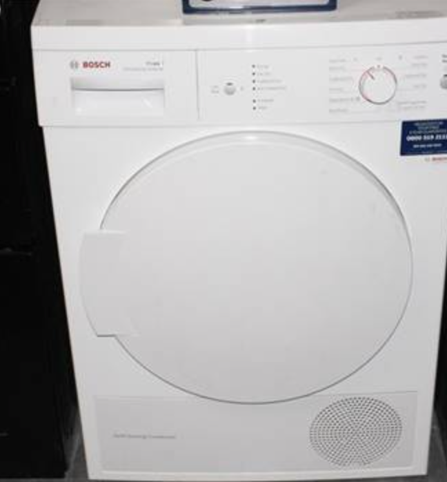

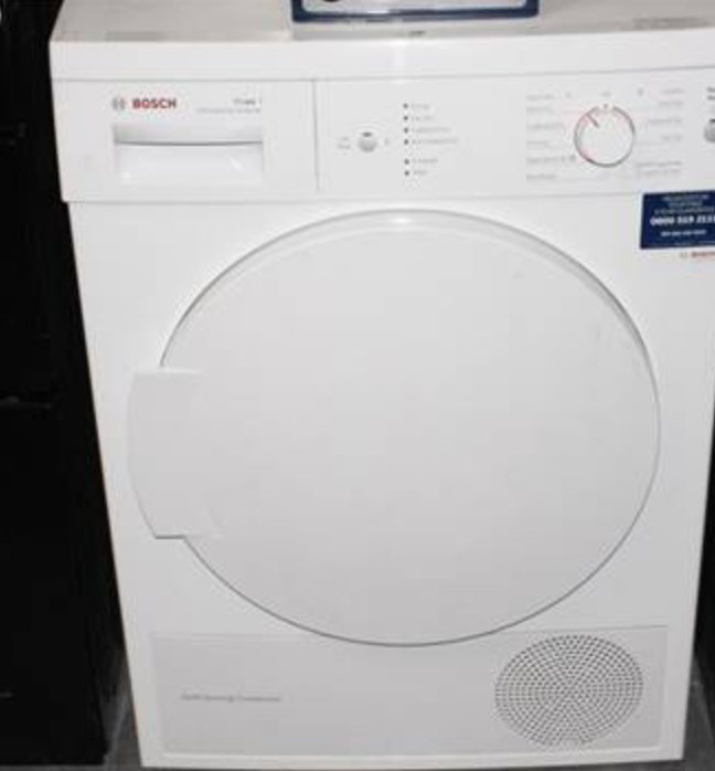

MHI PLEASE CAN SOME ONE HELP ME!! I've read every single thread but still unsure where to locate this secret flap. Ny machine looks like this, its the self cleaning maax 7. It's only just over a year old and suddenly its not drying clothes and some times the cycle finishes when its not dry and it's not collecting water ... where is the water going?? We've cleaned the filters, scrubbed the sensor for limescale and i dont know what to do but its stressing me out. this 'secret' flap you refer to.. is it on the front under the door or do we need to unscrew the back? Please am desperate! thanks!

On our machine - there's door on the bottom left that you have to open. Looks like you don't have that. Take the water reservoir at the top completely out and look inside with a torch and you will probably see the secret flap. Good luck.

If the machine is only a year old it should still be covered by the guarantee....I would go down that route first. If you start poking around with screwdrivers etc they might use that as excuse to void the guarantee.
If they won't cover it I would then start looking at how to remove the side panels and back etc, maybe look at their spare parts diagrams on the Bosch Website to try and work out where the water is going - I imagine it works like the one this thread is about.
The water collects in the bottom (under the secret flap) and it is pumped up a pipe to the collection tank all on the LHS of the machine. You might be able to see the pipe at the back - some of these machines allow you to feed the water collection into a drain so you don't need to empty the tank - you can see a small section of the pipe at the bottom of the machine...
Once you can locate the pump you need to check the area around the pump and that the pipe isn't blocked (or kinked)...
Also have you read your instruction manual? That might have a troubleshooting guide etc which could help ...(although the secret flap isn't mentioned in the instruction manuals for the non-self cleaning machines....)
