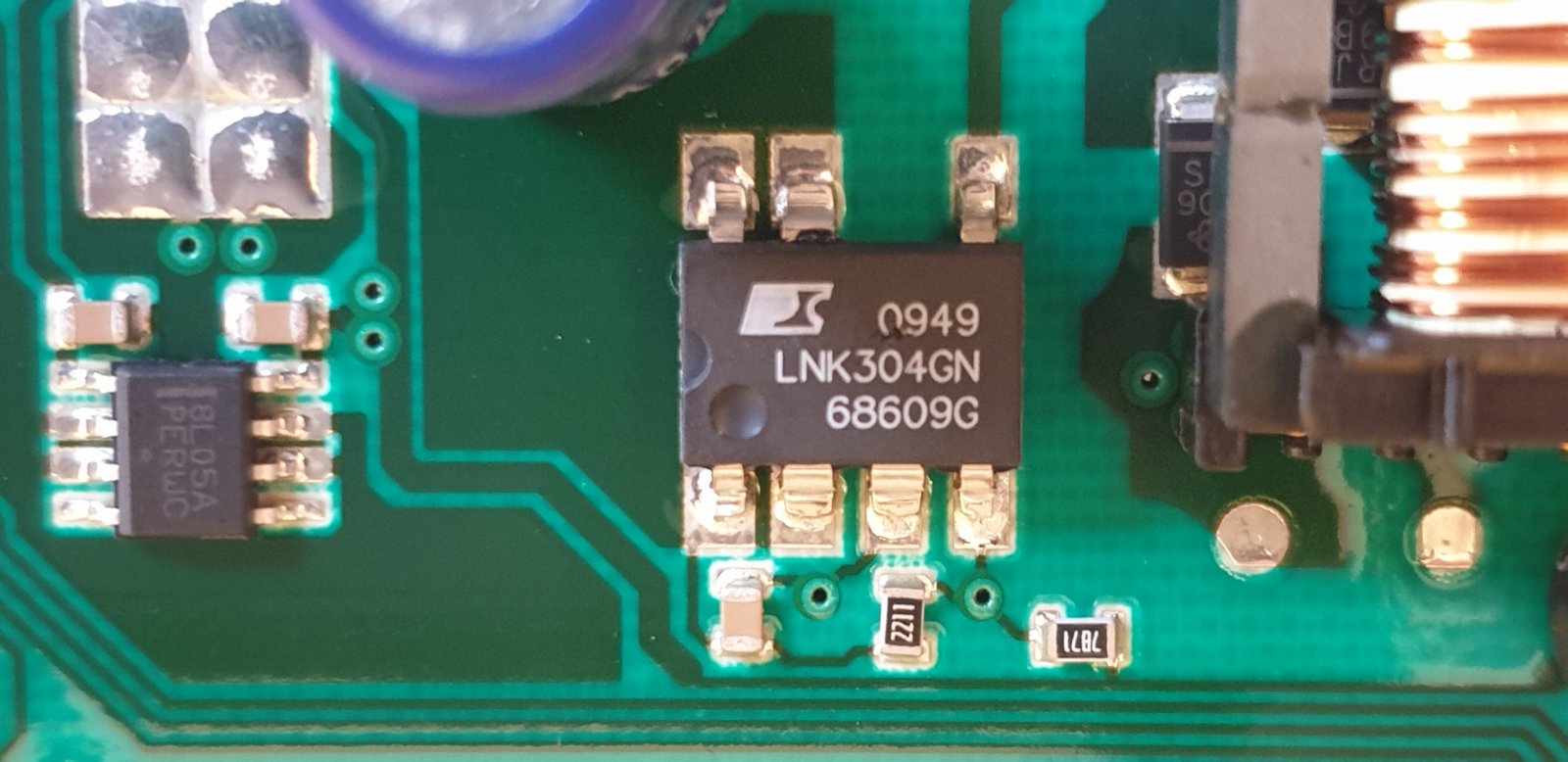

Hi,
My Dishwasher packed up yesterday and there appears to be no power, the display doesn't power up etc.

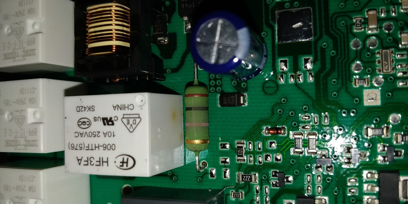

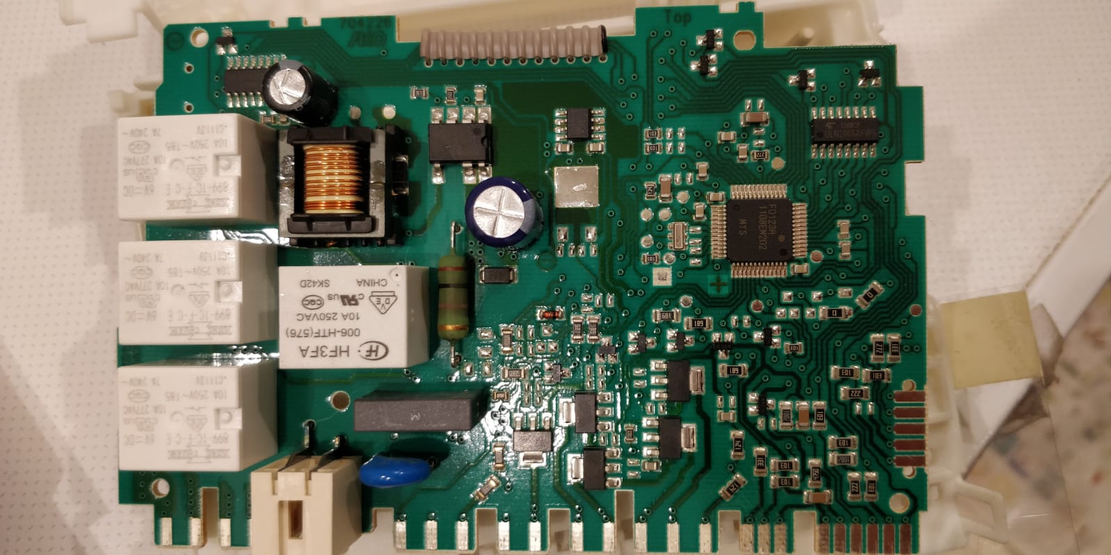

I've stripped the front of and checked that the mains is getting to the control module, and it was, so I removed the control module and opened it up to have a look.

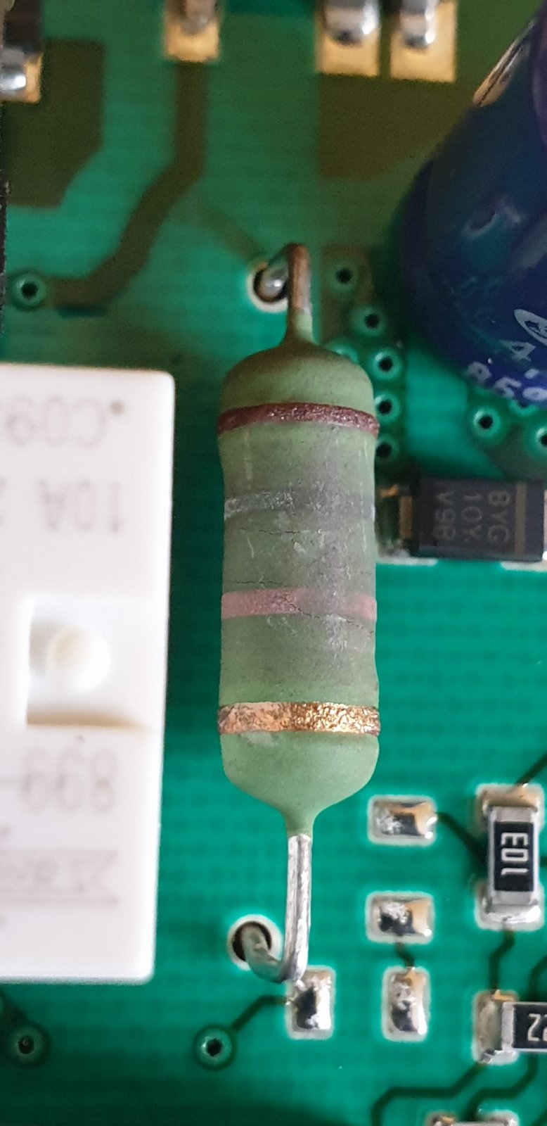

I found the Power controller IC had let then smoke out and, what I think is a 2W resistor, has gone open circuit due to overheating.
because of the overheating I'm not sure what the value of the resistor is, the datasheet for the LNK304GN shows an 8.2 ohm resistor in the application circuit but the band colours don't match that.
I can get a new IC from RS but does anyone have a clue what the value of the resistor is?
