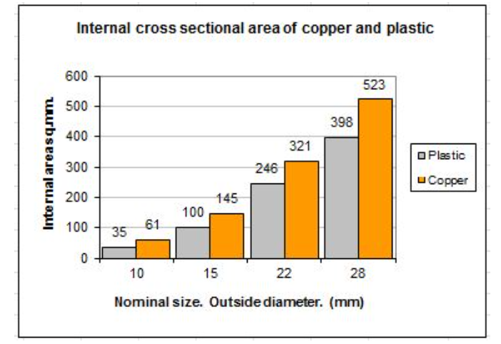

If it's on 10mm feeds then that's a big rad, is it one of the rads that doesn't heat up properly?
As per the quick sizing table of the HVAC design guide a piece of 10mm pipe will flow ~ 2.4Kw optimum, that's without any other loads, bends, restrictions etc using specific flow rates (1.5m/s), relative pump head and temps differentials. That's 10mm copper with soldered fittings, 10mm plastic will carry less due to the restrictions caused by inserts etc.
Just seen this. 10mm plastic only has just over half the internal cross section of copper! I'd no idea.

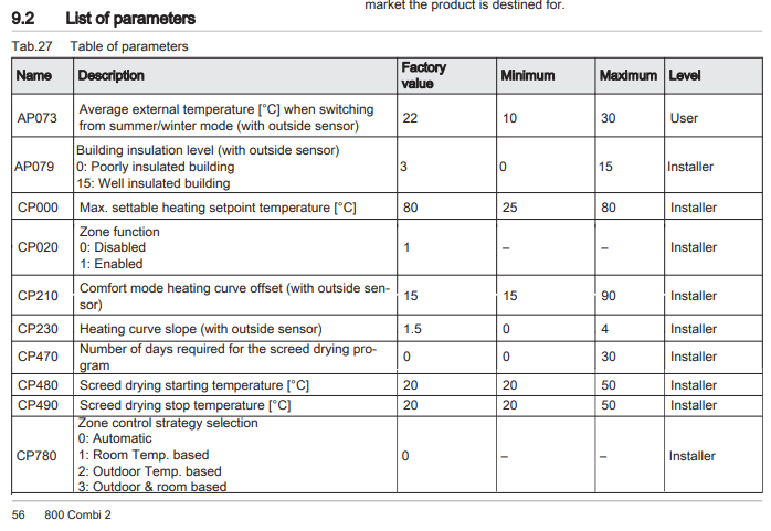

Your boiler probably has a setting which adjusts the heat input for the central heating. Has that been checked?
There could also be a problem with the gas pressure at the boiler input.
You could consider installing CLOSE COUPLED TEES with a extra circ pump which should almost doube the CH side head and theoretically increase the flowrate by ~ 40%, maybe first invest in a £20 IR gun and measure the boiler flow& return temps to give you a idea of the circulation flow. You might also contact Baxi and ask them, the primary heat exchager head loss and (at) flowrate and its pump head.
It looks like there's very few settings on this boiler. I can't see any which would adjust the power.
Some/most boilers display the actual flow temperature once you have set it (target temperature) so if both are the same then no problem with boiler output.
