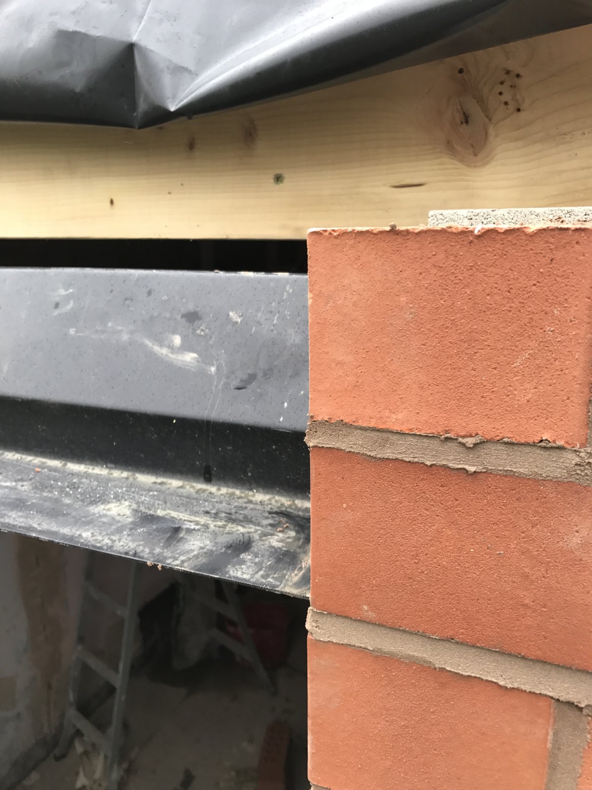

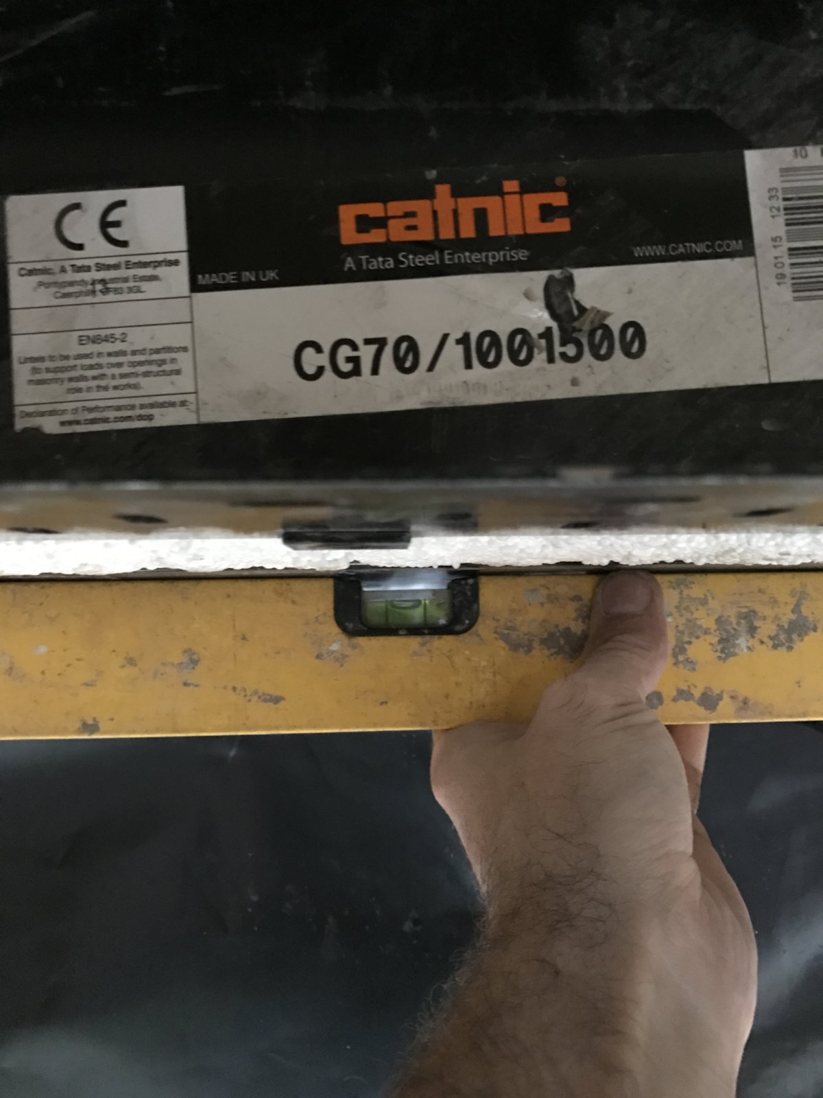

If it's a catnic lintel you could wedge a straight batten between the reveals at the correct height for the soldiers and mark the gauge on this. It also helps hold the bricks in place, especially usefull with difficult bricks.
Yes, it's a catnic.
So a piece of 4x1 in the outside opening so it will just touch the bricks where they overgang? Great idea, thanks :)
Yes the bricks usually overhang the lintel, and with certain bricks there is a tendancy to fall down and outwards a bit, so if the edge of the bricks rest on the batten it holds them steady.
As a novice, the way I did it was to have the lintel already bedded so it wasn't going to move, then I had the normal brick line to lay to, and plumbed each soldier with a boat level, also kept checking that the overhang over the lintel at the front was consistent.
I find the black catnics lintels with the flat front edge, much easier than some of the other types which have a downward sloped lip at the front, had a nightmare with one of those, as the bricks wanted to tip forward.

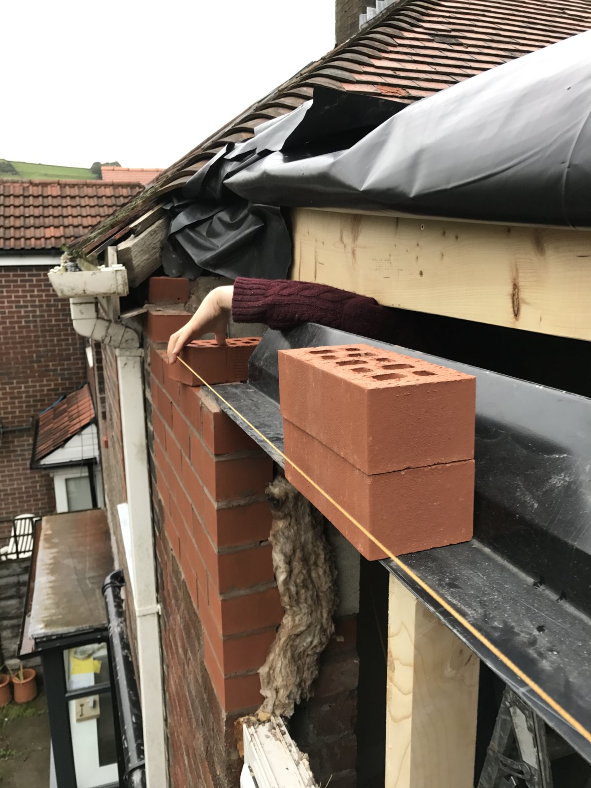

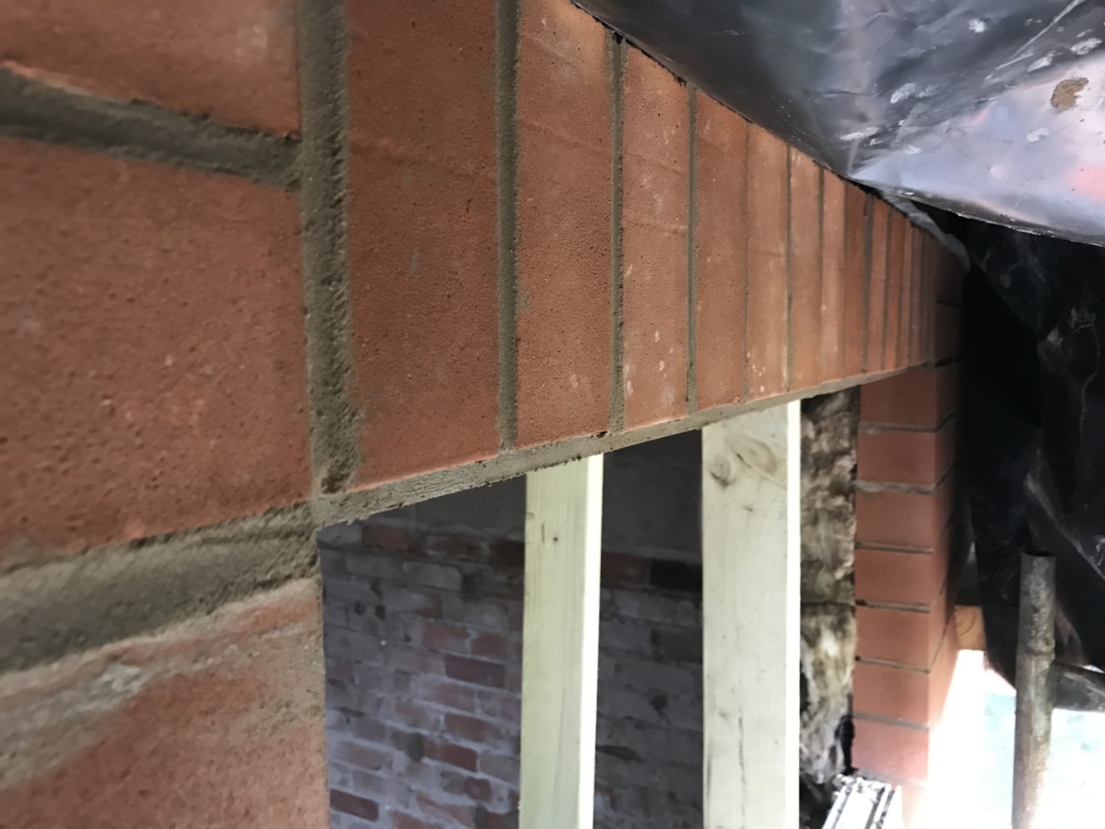

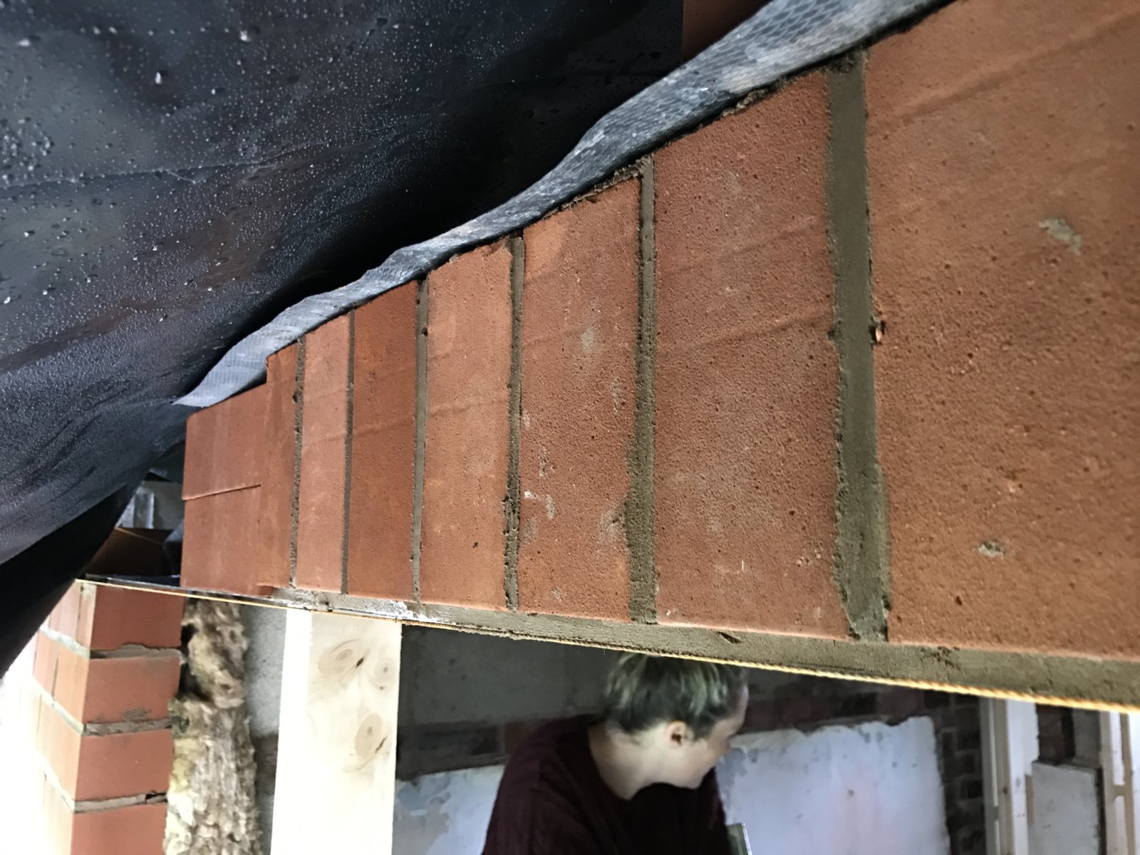

I've made a start this morning.
I propped the centre but didn't have anything thin enough to sit in the opening and over the lintel so I marked the centre and then just went accross measuring in multiples of 83mm.
Couple of pics:
It looks crap up close but if you stand at the top of the garden and squint a bit it looks pretty good (y):LOL:
I'm just past the middle so need to move the scaffold after a sandwich.

Thought you laying them overhand over the top of the lintel when I saw the first photo Ian. I was thinking you must be really good to do that.
Done now, it looks better than the rest of the house, which isn't hard to be honest
A couple of them lean out a bit more but you would only notice while your cleaning the gutters.
