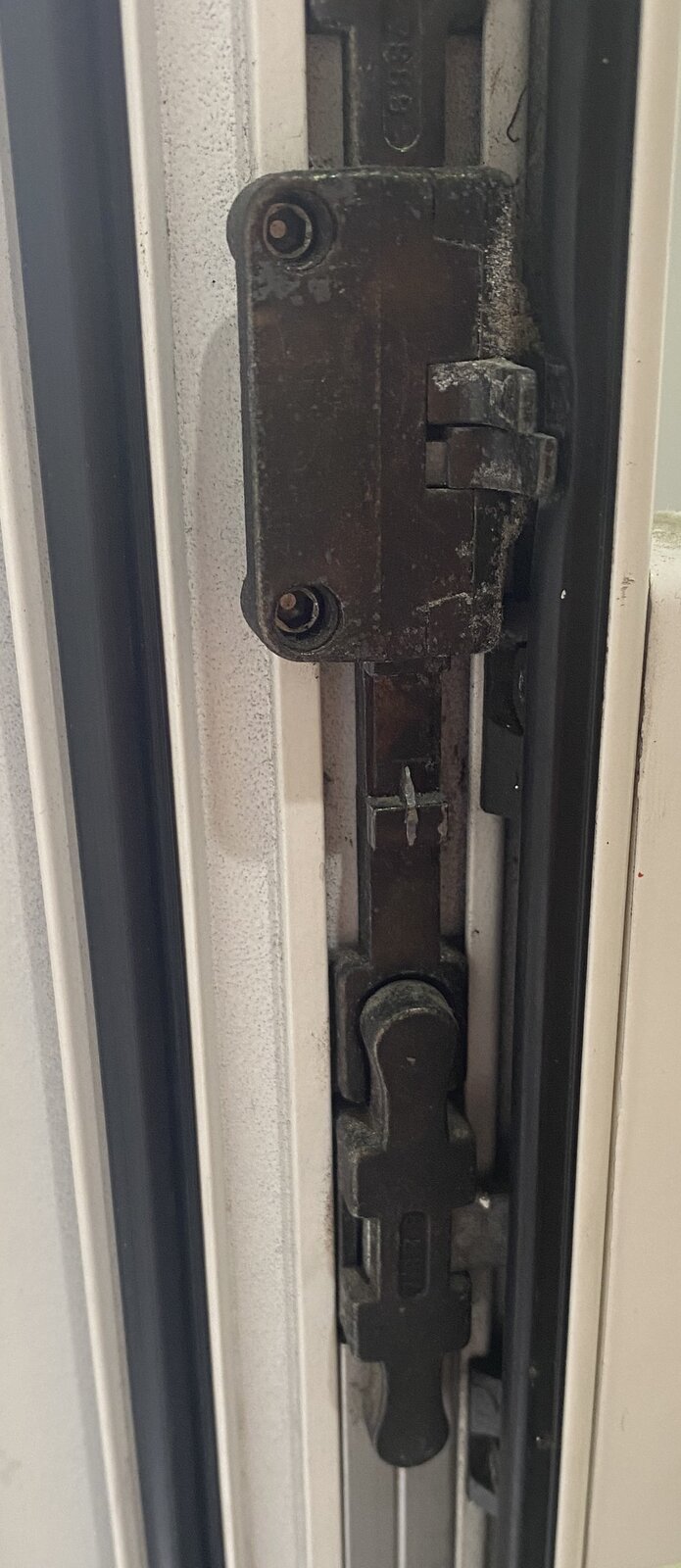

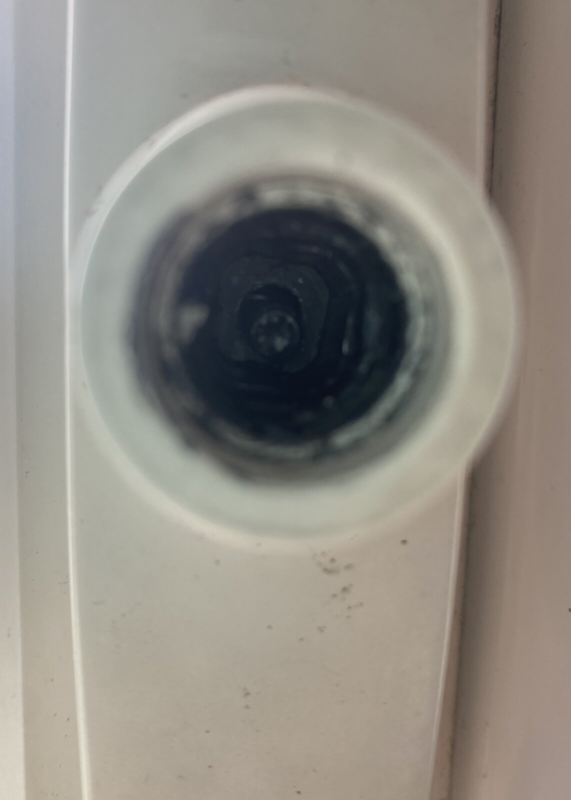

Broken window handle, no screw visible
Machine screw through hole in pic 5 to line with handle hole in pic 3?
Blup
The screw coming from back part of the handle and there is no way I can reach. In pic 5 I see one screw inside but that comes from back of as attached in screen. Do you know what type of model is this so might be documentation of the handle help

You need to replace whole handle set

Long nosed pliers to remove damaged screw.

You mean the one which is inside. Will this open the window or something extra to be done so handle can be remove ?

The alternative is to drill out the broken part, cobalt drill bits are suitable but will take a fair bit of effort.
