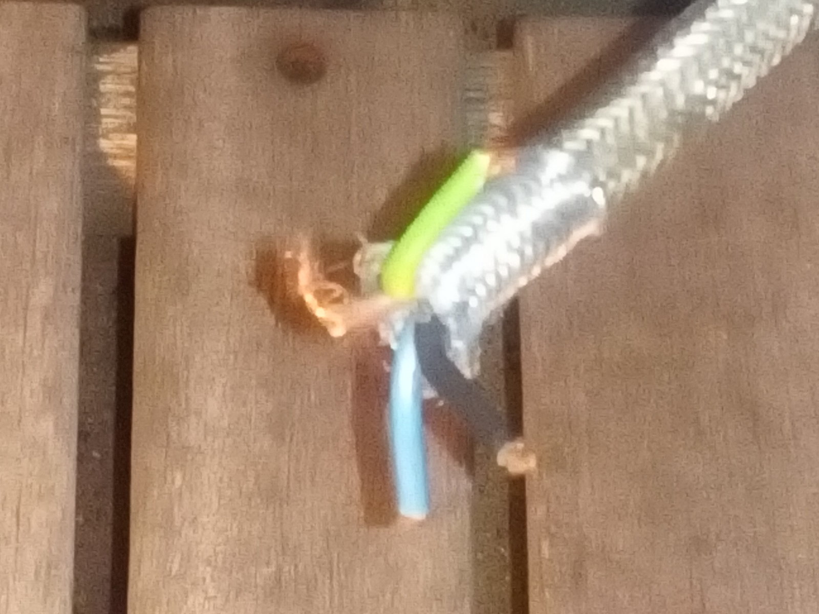

Brown, Blue, Black and G/Y flex?

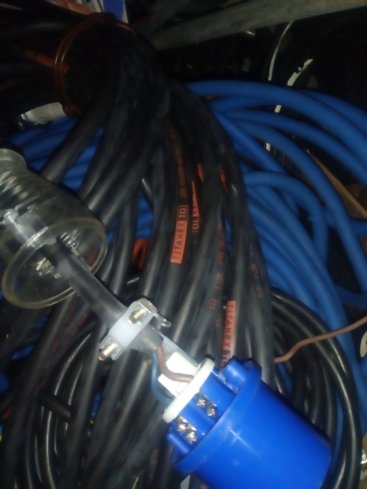

I've just had to replace a damaged plug on an extension lead.
This happens to be the last 25m or so of a drum of 2.5mm² butyl that I purchased from Newies in July 2018.
Ironically most of the original use was 3ph and I had to over sleeve with brown.
Even more ironic, grey silicon sleeves are easier to source than brown...

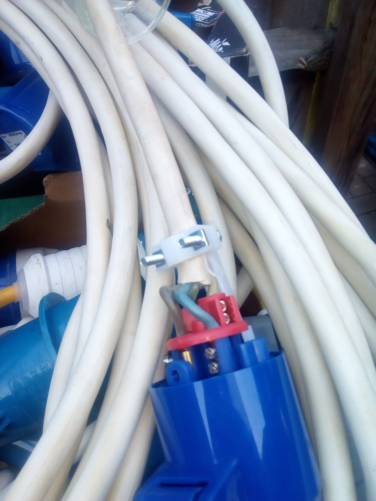

PATing and putting cables away for the winter.
This 4G1.5 rubber was purchased during the summer for loudspeakers, knowing where the job was my colleague would have got it from one of: Newies, city, RB Star, TLC or Edwardes. Some was used for this extention lead.

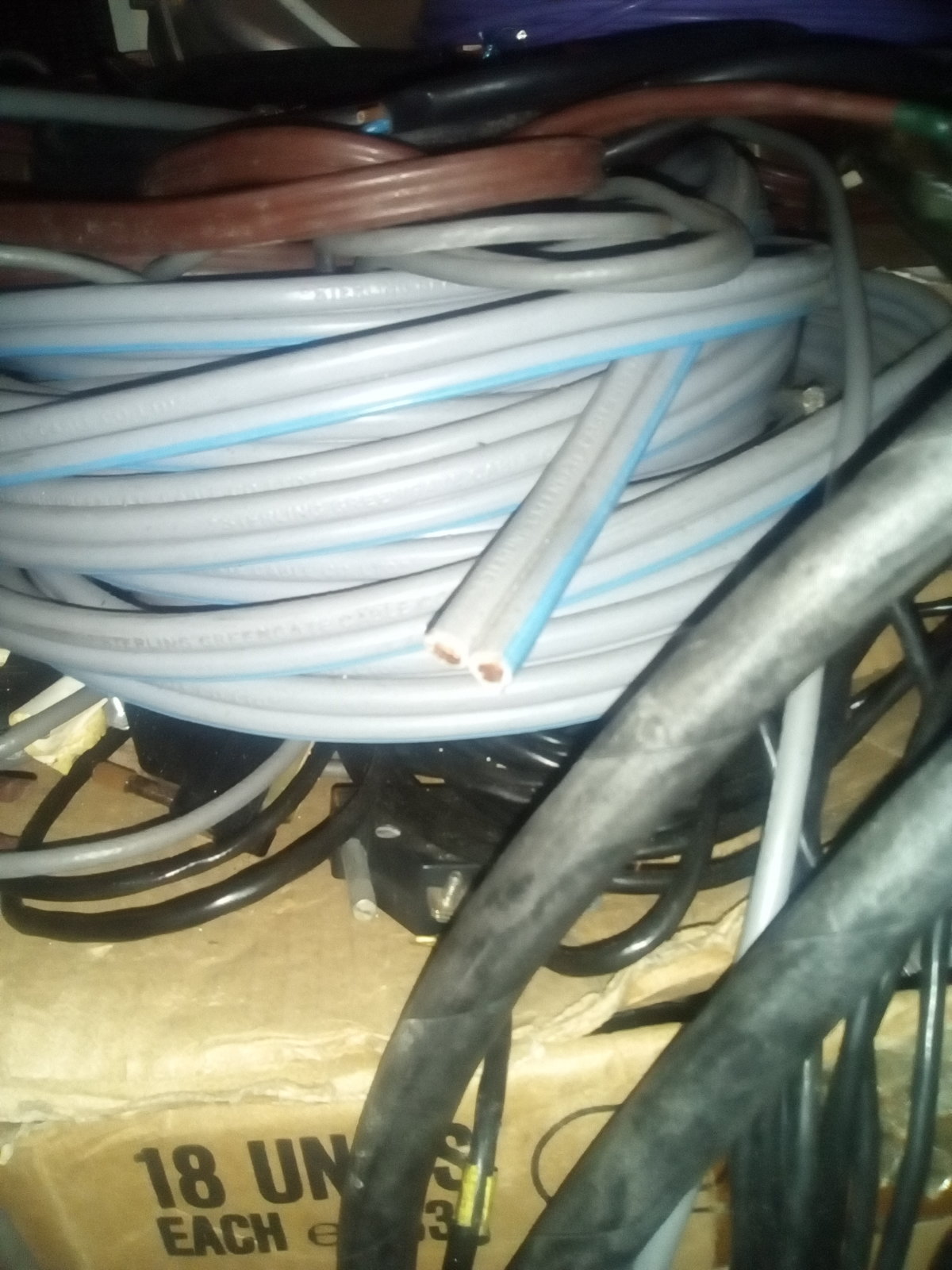

6mm² Brown twin with a ribbed polarity ident.
Grey/Blue 10mm² twin easy to source but Brown/Blue or Brown/Grey are not so easy.
