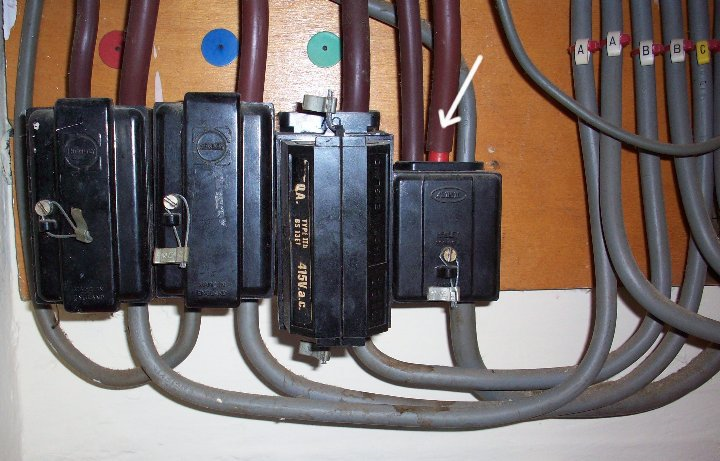

Our own phase colours have had a chequered history, as recently as the 50's they were red, green & blue [at least for the DNO].
You give way the age of my incoming supply (I hesitate to call it 'a cutout'), at least, in terms of the 'identication disks (and note the indicated red {and exposed!} insulation of the incoming neutral :) ). Notice also the 'A', 'B' and 'C' labelling of tails going to the meter! ...

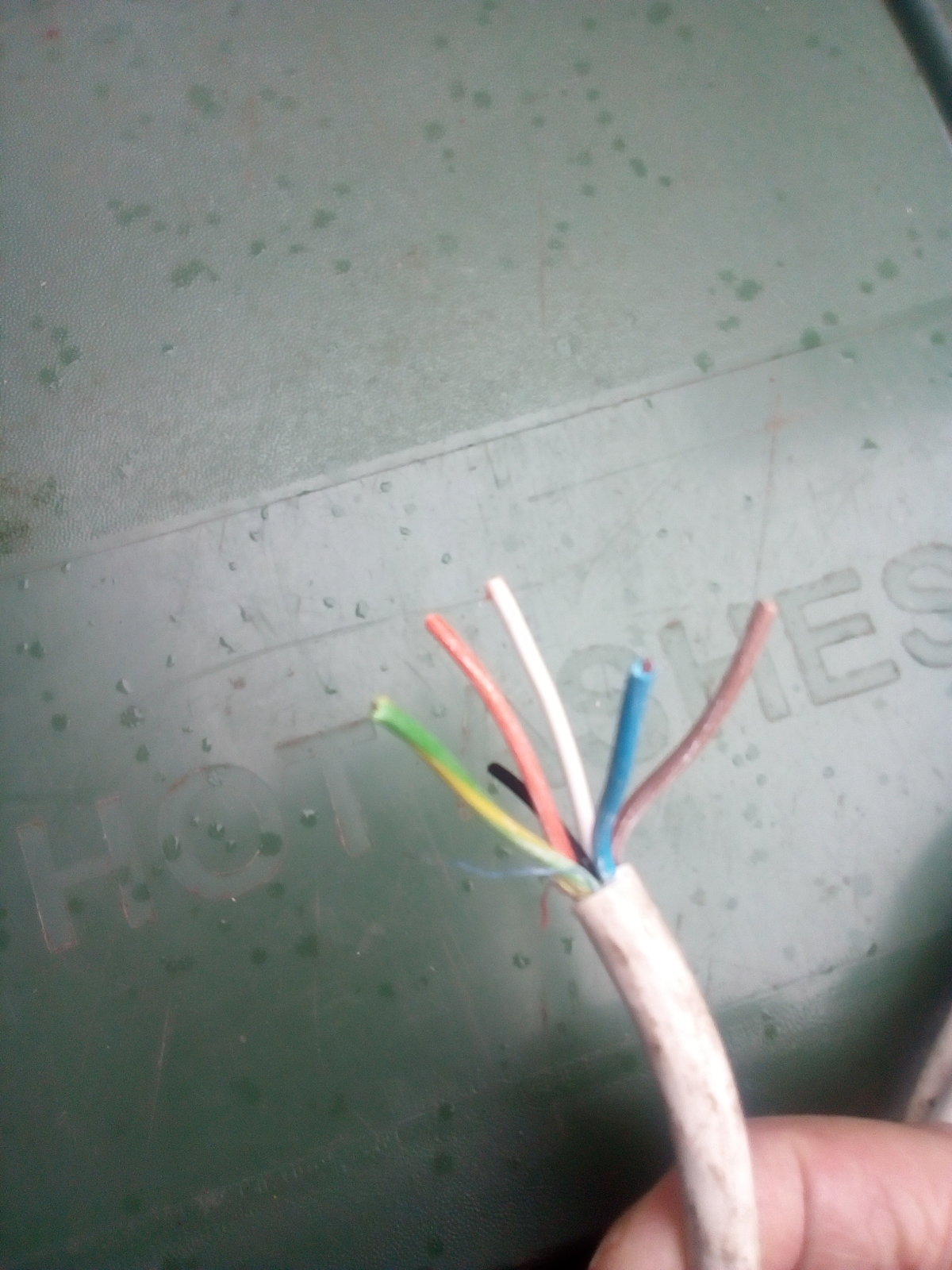

In the mean time I'd personally stick with the 4 & 5 core combinations that I most commonly find: brown, blue, black[or red], green/yellow plus grey[or white] for 5C. Generally I can make most sense of those. If I'm in a position where i'm offered a selection of colour schemes, which is frequently the case, I'll obviously look at the current requirement and go with the best combination to suit.
Oh and this piece sourced last year in that well known colour scheme: blue, brown, white, red, green/yellow. Yes it is red, I've just double checked.
