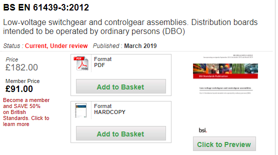

Found it - but the only 61439-3 is from 2012. ... Is there a newer version?
That seems to 'depend'. The below is the 'current' version being offered for sale by BSI. It's called BS EN 61439-3:2012, but, as you see, says it was published in March 2019 -so I guess probably includes contains Amendments. What's the 'publication date' on the version you're looking at?
Kind Regards, John
Same as the one your looking at. (I didn't notice this before)
HOW MUCH :eek: Yes, without access via public libraries (or for some of us, a work subscription to the online service), it would indeed be a very expensive business getting these.
Checking online, the 2019 edition includes corrigenda from March 2016 and December 2015.
