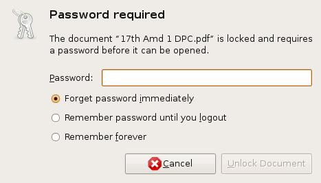

no password needed..

Isn't DRM fun? Acroread (the unholy, awful, bloated POS) will open it on Linux. I doubt anything else will..
Ah, that's the problem. Bloody DRM. :evil:
I'm downloading that Acroread now, I'll see how it goes. Cheers for the pointers.
Other than telling them who you are, where you've opened it, and how you're reading it, it'll go just fine.
