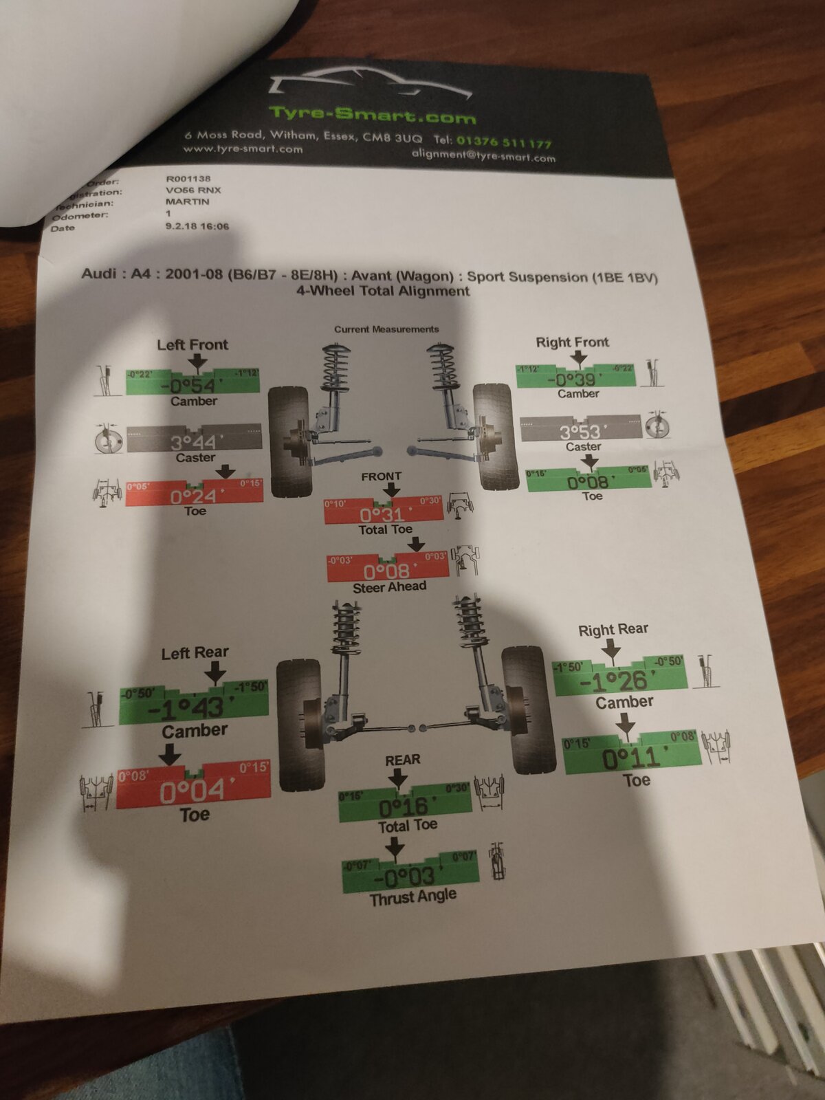

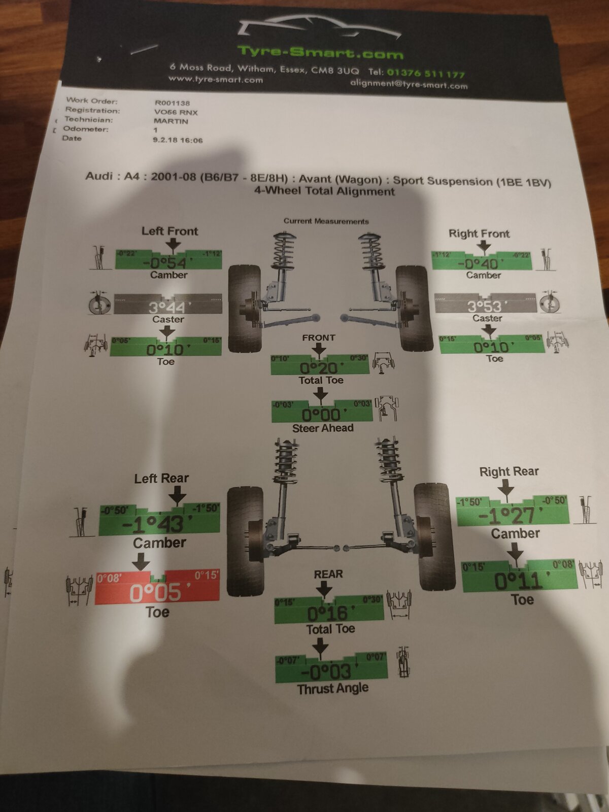

Anyhoo, I just found the print outs from the last time we had the 4 wheel alignment done when the tyres were first installed,
It has had a couple of control arms on the driver's side since though so it may be it was never tracked correctly after this even though it drive straight..

I can't see much wrong there. Even before the adjustment. All they did was tweak the front toe setting slightly. I can't see anything there that would cause such a dramatic difference in wear across the width of the tyre. OK, I don't know what the settings for the Audi SHOULD be, but none of them look wildly out.
They can drive straight with the tracking badly out. Some manufacturers like to run a bit of toe-out because it makes the car turn-in a bit more aggressively. Handy as a "fudge" if you have a nose-heavy car that understeers a bit more than you'd like. I'd be interested to see your "before" and "after" printouts this time?
