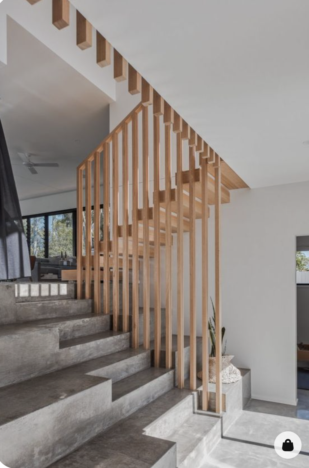

The provisionals are mostly end stages of the build - kitchen, joinery, sanitaryware. Only the staircase has been quoted on so far.
Hardwood timber stairs - provisional £15k
Actual spec - Bottom boxed section made up of wood, plywood and cement board ready for cement coating (not incl.) 5 steps.
Top return - 8 step single stringer with softwood treads. Stringer requires concrete pad. Suggested removing all floorboards from below existing stairs and infilling with concrete to support the new base.
Balustrades - 34x69mm spindles
See image attached which is very similar to how it should appear (only double width at base - ledges sitting under stair return only)
Quoted price - £27k

View attachment 320164View attachment 320164

The 27k is for the staircase.
£6750 for concrete base, pad foundation and steel stringer - reasonable.
£6500 for build up of wooden base - for micro cement finish (by others). Seems very high for basic wood build up.
£3500 for 8 softwood treads to top half. ‍♀️
£10,500 for wooden spindles and ballustrade to landing.

Yeah, it's hardly a generic "input your total rise and number of treads and in 3 weeks we'll ship you a 42 degree MDF and pine staircase you can bolt in and cover with carpet" affair though is it? Perhaps more a case of wanting the very best but don't like the price tag? 8 years ago I was getting quotes of 20k in for huge chunky hardwood bespoke stairs and I realised I was off my rocker. Paid a local joinery firm 3k for a bespoke thing made out of kitchen worktop and it gets a lot of attention at a fraction of the price. Still think 3k is a bit potty for stairs but I'm making another set the same myself, and the price rise is astonishing - I could pay 130 quid for a 4m length of beech 8 years ago, I paid 180 three years ago and the same supplier now wants 255 for the same thing

the picture shows a highly bespoke staircase that will take a long time to set out and construct
Im not sure what the treads are - are they supported by the spindles or are they cantilever?

He probably quoted for a standard Stringer staircase from his usual joinery firm or staircase maker and a ballpark for his carpenters to do a standard fit.
