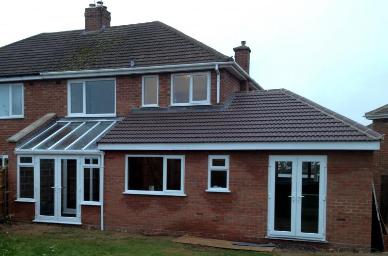

With the exception of fitting guttering, the external work is now complete. 1st fix gas, electricity & plumbing has also been done this week and we are ready to screed the floor and insulate the ceilings before plastering.
Why the fook was the guttering not fixed whilst the scaffold was in place?
Guttering is fundamental and is relatively simple to fix, yet does such an important job regards protecting the building.
Get it on, now!
Get it on, now!
Especially given its taking the main roof too.
That downpipe from the main roof has been cut too short, you risk a damp patch on that wall. At very least it needs a shoe on the end to throw the water away from the wall!
Simply because one or two of the poles would have made fixing the guttering earlier awkward. Don't worry, it's going up today, and I have the 'luxury' of unimpeded access, and the ability to run my eye down the entire runs to check for alignment.
As for the existing downpipe, it hasn't been cut short, but is the original pipe, severed at one of its joints to facilitate the build. I'm replacing it from the top, with new brackets and a proper shoe.
Ironically, from the day we broke ground to the day the roof was covered, there were only two days on which there was no rain. Since the day the roof was covered, there has been just one brief shower. I could have collected all the water from that downpipe in a bucket!

Fair enough regarding my comment over the downpipe, never know what may have been 'missed' so thought I'd point it out. Would be a shame to risk a damp problem for the sake of a couple of £ for a shoe. ;)
