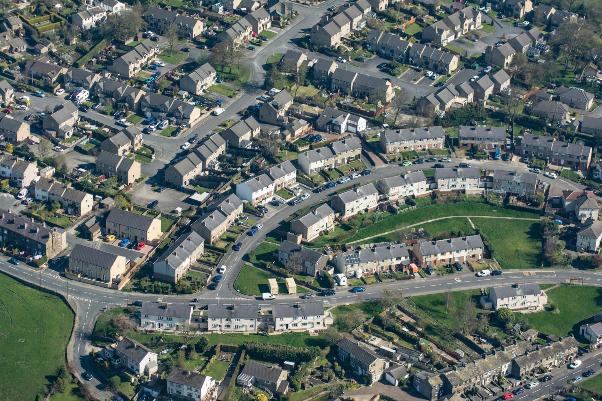

But back on-topic... Does anyone build poured concrete houses that actually have a cavity? The no-fines concrete is intended to replace a cavity by having many small voids within a single wall rather than two walls with an air gap. The problem was of course damp. Greece is obviously a lot warmer than the UK, so insulation matters less, plus they get a fraction of the rainfall.

They were part poured, part prefabricated concrete panels, where the panels were structural. Floor poured, panels erected and bolted down, then another floor laid. Except on some, they skimped on the fixing bolts.
I lived in a tower block back in the 90s. The old caretaker I chatted to was there when it was built in the 1960s. He said that they had a set of moulds to cast one complete floor (6 flats), they filled it with concrete, poured the roof then took it all off and moved it all on top, repeat 15 times until you've got a tower block. I don't think any of it was prefabricated, but others were, there were various systems made by different companies. I didn't know whether it had a cavity or not, I suspect not as it was clad in more recent years (and now needs replacing with the non-deadly variety).
It would be very difficult to cast a cavity wall, I can't imagine how you could slide a 100mm wide mould slab out of the middle of a 2.5m tall wall without the mould or the wall breaking. Presumably this is why they made it using the "no fines" method instead, where thousands of air pockets throughout the wall allegedly provided similar insulation to a cavity...
...neither of which have cavities, I suspect the answer is that pouring a wall with a cavity probably wouldn't work, so they cooked up this "no fines" nonsense instead.
Probably all works OK in Greece but not in damp, cold Britain.

Laings easyform have a 50mm cavity.
Apologies, yes you're right.
The next form of Easiform homes were built during around 1925 to 1945. They had a cavity separating the inner and outer walls. The other wall was three inches thick with a two-inch cavity. The home was usually finished with pebble-dashing.
I'm guessing that they must put some sort of formwork in for the cavity then just leave it in. I can't see how they could slide out a 2" former from a 3" wall, it would just fall apart.
It was probably as expensive to build as brick once they added the need for a cavity. The skill level must be pretty similar too, given the other details of inserting reinforcing rods around windows etc.
