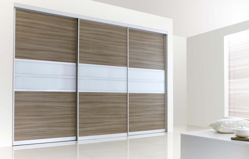

The wardrobes have three doors (the two end doors will be on the back rail and the middle door will be on the front rail) so I was planning on putting a push-to-break switch on either of the end doors so that when the doors are at the extreme left and right the switches will hit the wall and the circuit will be broken and no lights will come up. But I'm a bit stuck on the middle door. I can't think of a way to connect this to a switch as 1) the door will not rest against a wall 2) If I added anything to the door or ceiling to hit a switch it would likely hit one of the other doors when they were opened.

Sorry I forgot to mention a key point - the doors are sliding doors with the middle door being in front of the two side doors like this:
My method would be three magnetic reed switches in series ( contact closed when door closed ) and an intelligent relay to control the 230 volt supply to the lamps when any contact was open.
Will need some thought as to the selection of the relay as it will need to supply a safe ELV to the reed switches and operate when the input goes open circuit.

Rather more complicated than it needs to be IMO…...

The complication is being able to fit a switch that is operated by the middle door yet does not stop the side doors sliding behind the middle door.
If the middle door slid behind the side doors then three simple switches could be fitted.
